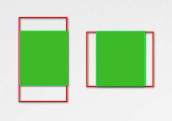

Hello.
I want to process a pack of images with different scales - need to crop and resize to 4:3 scale.
For example, on screenshot: red rectangles - source images, green - desired results.
Initialy I used this command:
nconvert -ratio -resize 0 2000 -canvas 1500 2000 center -i -o dest.jpg source.jpg
It was good for one type of images, but for second - it leaves black lines on a sides of image.
Is there solution to use one line command to deal with both types of scales?
May be canvas longest, resize longest
Have no ideas...

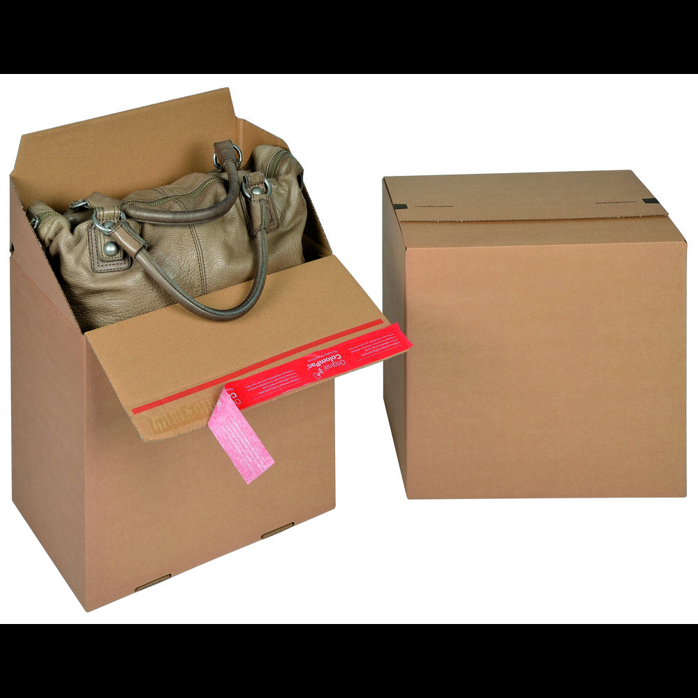

j'ai le même problème,
nconvert -ratio -rtype lanczos -rflag orient -resize 600 600 -canvas 600 600 center -bgcolor 255 255 255 "C:/PHOTOS/AL23512-PD01.jpg"
le fond est noir
