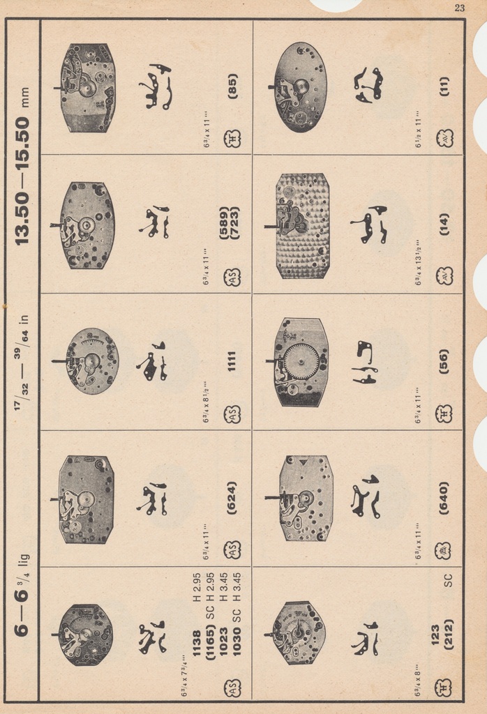

I create PDF files from old scanned books and reference catalogs. These books often have yellowed pages, or darkened with age. Do you have tips on how to best improve the look of the pages?

My attached files are the original scanned page that has a brown background that is partly from age and partly from the color when it was originally printed. The processed image has the background whitened, with what I think are minimal impacts to the page contents. It's important that the pictures or drawings not lose detail. My files are all PNG but needed to compress and convert to JPG for posting.
My script that processed the attached image looked like this:
  • Gammasat 0.17
    Levels Black point = 62, White point = 218
    HLS. Hue = 0, Lightness = Lightness = 2, Saturation = -6
While developing the script, I found that "ghosting", the image from the back of the page shows through, so I had to whiten the page further to get rid of that.
While writing this post, I did a bit of research on the web and found advice that said to play with the levels in the histogram. These XnConvert commands play with levels so I know I'm on the right track with it all.
I'm really happy with the outcomes so far, but am looking for any advice other may have, especially if you've done them with XnConvert.
One of the pages that has been processed
Page 014 Whitened.jpg (113.13 KiB) Viewed 2511 times
Another page that was processed
Page 051 Whitened.jpg (168.82 KiB) Viewed 2511 times
An original page that has a dark background
Page 051 Original.jpg (241.53 KiB) Viewed 2511 times
