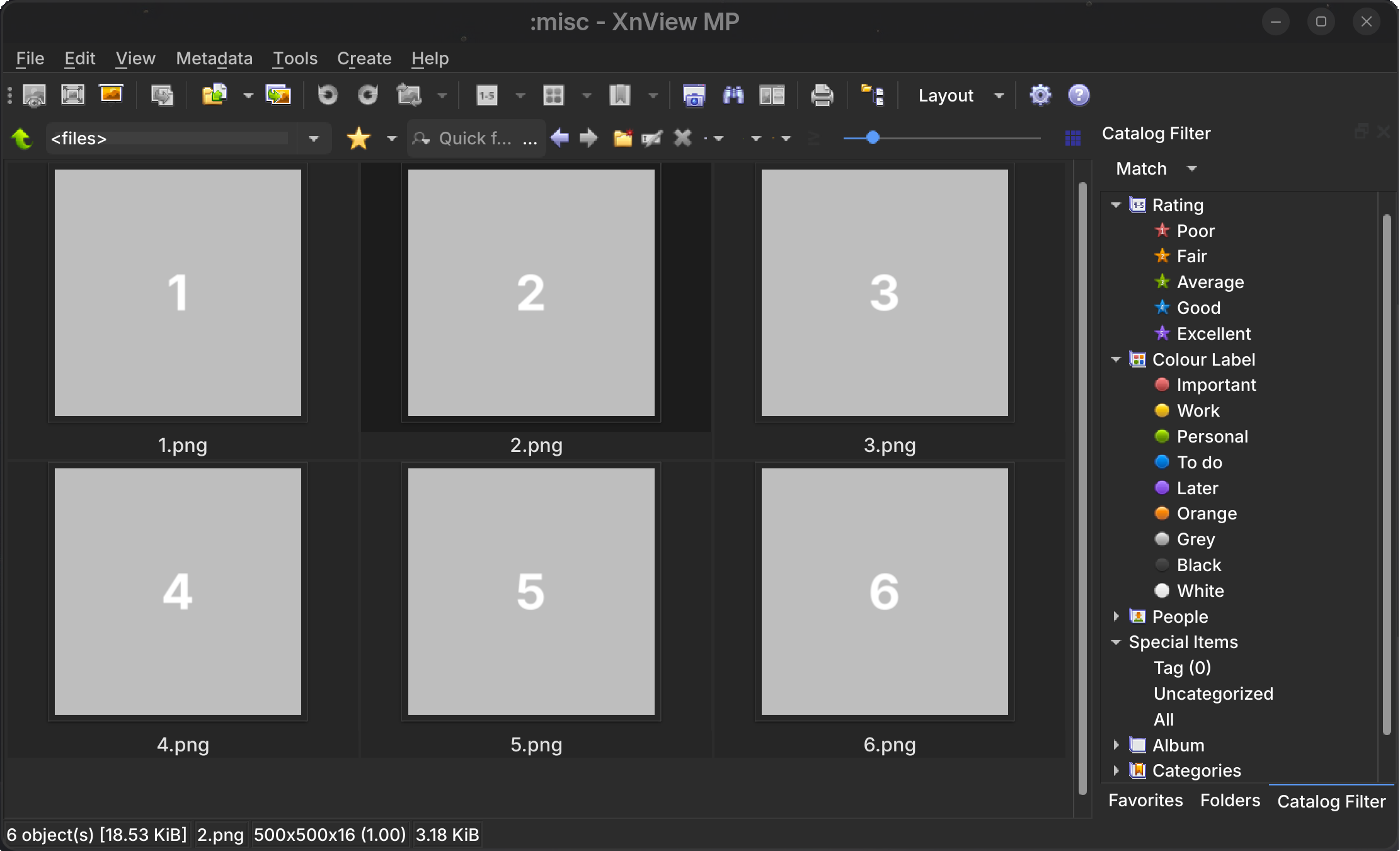

Actual Outcome
The browser does not match the sort order in my filelist.txt. The files are sorted using the last selected sorting from the "Sort by" toolbar menu.
I generated 6 example PNG images, to explain my point. See FIG1.
I want the images sorted according to my own order, specified in the filelist.txt => 1, 3, 2, 5, 4, 6.
FIG 1
Shows loaded filelist *not* sorted according to filelist.txt

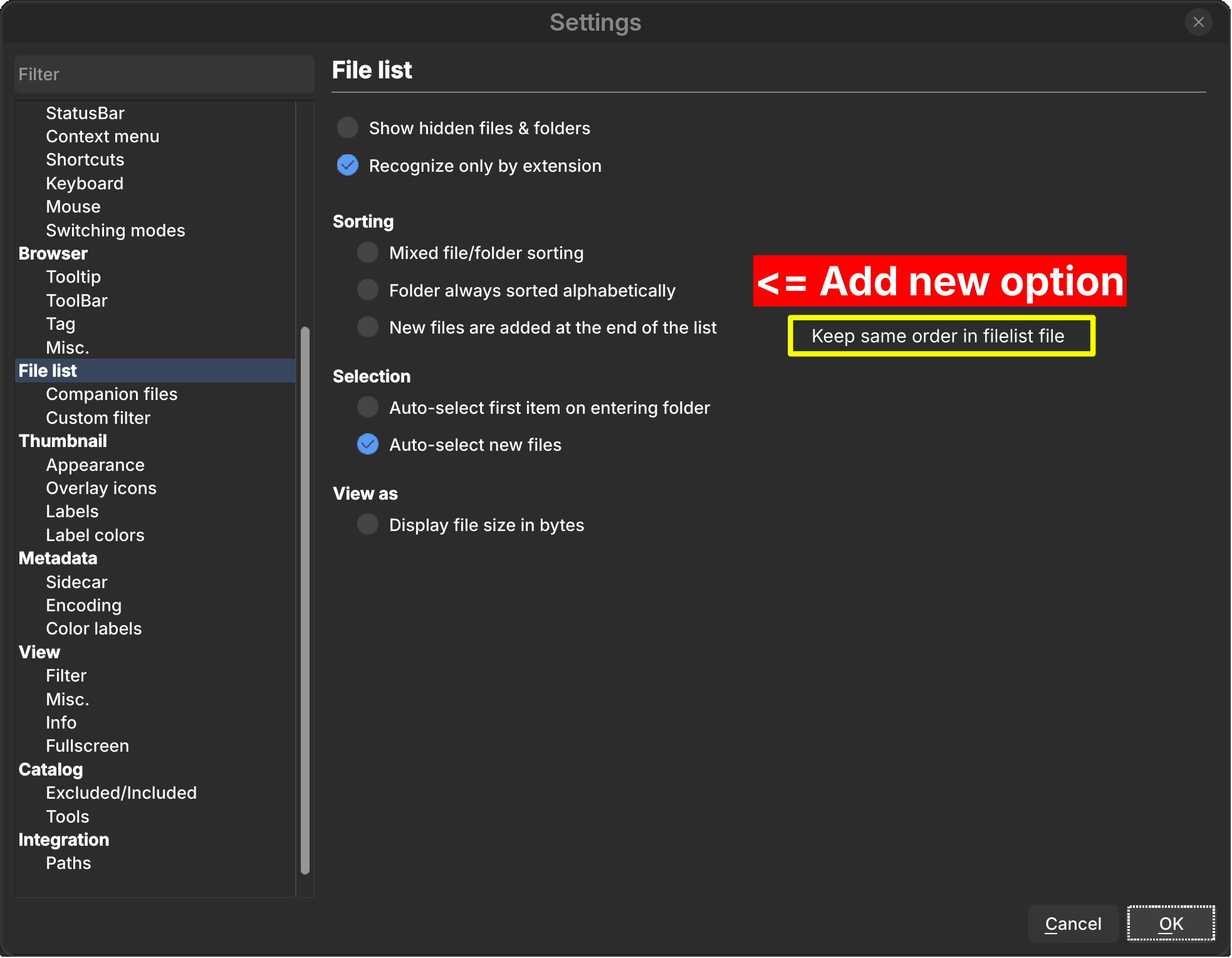

Suggestion for Bug Fix:
  1. Add Settings Option:
    Add option in Settings to globally set whether to match the sort order from wtihin the filelist FILE.
    FIG 2
    BUG FIX: Add option to match sort order in filelist

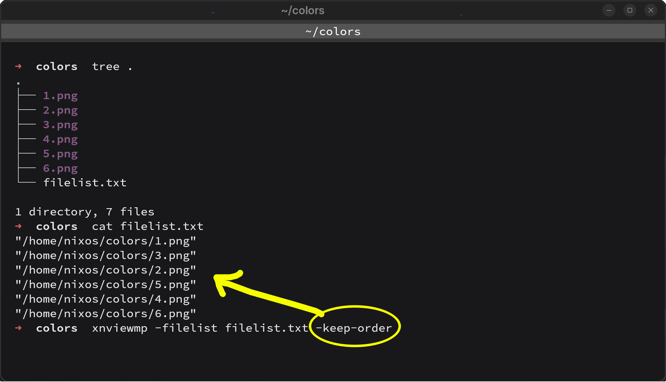

  2. Add Command-line Option:
    If the settings option "Keep same order in filelist file" is not enabled (unchecked).
    Provide another method. The user can pass a command-line option, when loading a filelist. For example "-keep-order".
    xnviewmp -filelist filelist.txt -keep-order
    FIG4
    Arg -keep-order for -filelist option

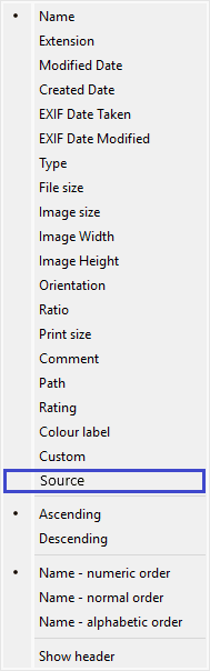

Maybe new 'Source' option in 'Sort by' menu (as this is the place where all sort options exist)

My suggestion is to introduce a new option to override the default behaviour, using a globally set option.
Refer to FIG2 image.

user0 wrote: Mon May 26, 2025 2:56 pm Maybe new 'Source' option in 'Sort by' menu (as this is the place where all sort options exist)
I am unclear as to what you mean by "Source".
If by "Source", you mean copy the order as it appears in the "source" FILELIST file. Then Yes, I have no problem with that. But it should be in addition to the globally set Settings option. By that I mean, the developer provides both ways of accessing the feature. Otherwise, a user would have to select that button in "Sort by" menu, each time they load a FILELIST. This would affect usability and ease of use. That's why there should be a Settings option, for users that want this always enabled.

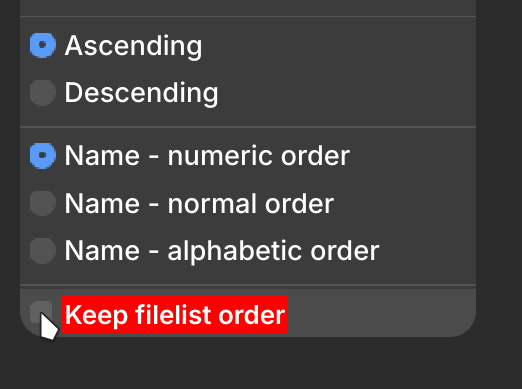

Update:
Actually. This could be a toggle checkbox element, rather than a button element. Which would solve the issue I mentioned above.
In which case, the user could enable a toggle checkbox, as an item in the "Sort by" menu,
FIG3
Keep filelist order option
The developer can make the appropriate choice, on where to place the option.

- Enable option via command-line argument. See FIG4.
- Use toggle button in "Sort by" dropdown menu, to enable option in GUI when needed. See FIG3.

  • ONLY IF TRUE that the toggle button in "Sort by" dropdown menu is UNCHECKED. See FIG3.
[*] IF the sort order was changed (2). To re-sort using the same order in the filelist file (without reloading the filelist).
[*] The user can use the toggle button in "Sort by" dropdown menu ". See FIG3.

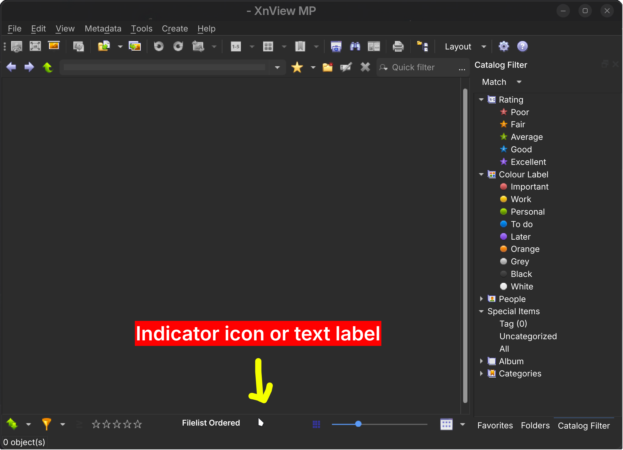

* The Filelist could have a top line of options, prefixed with * (which won't appear in a file name) specifying what to do when opened, which could include sorting but could include other settings, perhaps in the format of command-line options (using the same names where coinciding). I think this self-declaration would be very useful.
* View - Sort By could have an "Unsorted" or "Default" option which for a filelist would be the filelist's order
* I don't think a global setting is too helpful since some filelists are ordered and some are not, which is why I think it's better if the filelist itself declares whether it is an ordered list or not, however there's no harm in a global setting if the filelist doesn't self-declare
* Whether a filelist is ordered or not could also be indicated (where nowhere else indicates) by its extension or name pattern, e.g. mylist-ordered.txt
* Holding down modifiers when OKing the Open Filelist... dialog could also allow the user to state whether to use the current sorted order or the filelist order, or the dialog could have two open buttons, one for opening with the current sort, one for opening with the Filelist order.
* Provide shortcuttable commands to adjust the sorting, including one for Unsorted (i.e. Filelist order).
* Sorting provided by the command line

In version 1.9.0, some of the toolbar buttons have moved to the bottom.
There could be an indicator that informs the user whether the browser sorts according to the FILELIST order.
* The label must be short that's why I opted for "Filelist Ordered".
* The label would not be centered as shown in FIG5, but should be aligned to either the left or right of the toolbar.
FIG5
Add indicator to bottom

  • option location
    'Sort by' menu (in Browser) should be the only one place for this new sorting option
    it will:
    - explicitly show current sorting method
    - allow to select any other option and return back to Source

    If you want source order to be applied automatically and only temporarily (until <files> path or sort order is changed) when loading txt file manually via 'Open file list...' - new 'Use source sort order for file list' checkbox should be added in Settings > Filelist (as per OP's request).
    However, I think he will bring more mess than good with his behavior. Manual switching to Source option is more than enough.
  • command line
    Better to use -order-source as a more general approach, allowing any other orders to be added in future (eg -order-name)

To summarize the suggestions so far.
  • Enable Feature: From Settings
    • Option in "Tools > Settings > File list". See FIG2.
      This would define a global value for the browser to ALWAYS sort files according the order in the loaded FILELIST file.
    • To better emphasis that this option is a global override - Which means, it has the highest precedence. You could name the option "Always source order from the filelist".

  • Enable Feature: From Command-line
    • New argument flag "-source-order". See FIG4. That would be read by OPTION -filelist.
      xnviewmp -filelist FILELIST -source-order
    • This allows users to NOT set the option globally in the Settings. But use the feature when necessary via the command-line.
  • Enable Feature: From Toggle (radio) button in "Sort By" menu
    • This allows users to NOT set the option globally in the GUI. But use the feature when necessary via a toggle button (Qt radio button).
    • The toggle button in FIG3 would be a way to toggle the feature ON or OFF.
