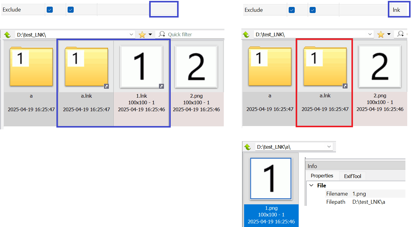

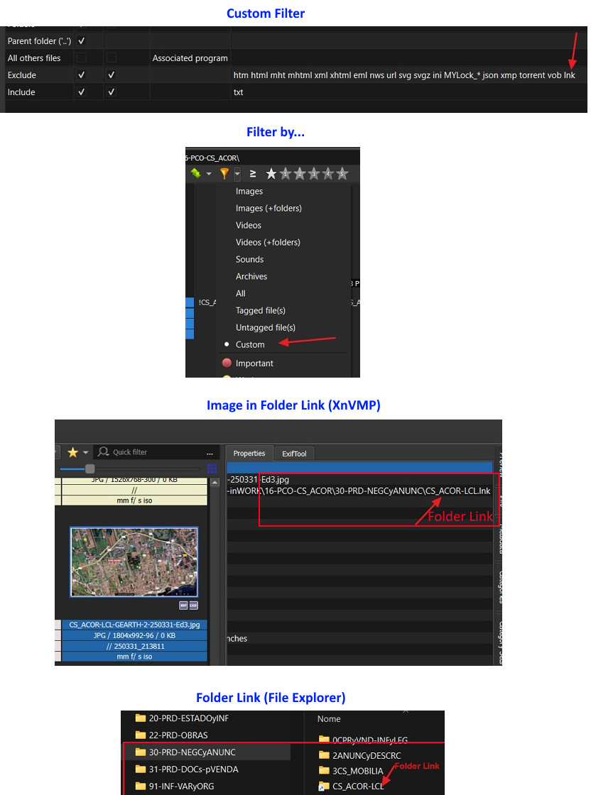

I don't see it in the dashboard thumbnails!... See the image!
_________
On the other hand, Browser's Custom filter (Settings>Filelist) allows to exclude lnk.
No! See the image I put!
_________
However, it only works with lnk to files and ignores lnk to folders.

NOTE: This example, shown in the image, was intentionally created to demonstrate the problem I mentioned in my first post!
PCO
Posts: 2411
Re: XnView MP and shell links
v1.8.8
..\1.lnk
..\a.lnk

XnVMP 1.8.8
The simulation you present is biased concerning the problem I pose, for the following reasons:
—Starting from a root folder, which contains a tree of subfolders with the images/photos—
1) I don't have links to files, and your simulation does!
2) I have, at most, one or two links to some subfolders of the tree (these links derive from the need for a cross-organization, when I navigate through a "File Manager" — in the strict sense of it)!
3) I have XnVMP configured so that the folders are not visible (I'm not interested in seeing the folders, but their contents!) in the panel in browser mode:
I use "Show files in subfolders" mode and I do the desired sorting.
4) to verify what I explained in the 1st post, remove the link file to file "1", keep file "1" in folder "a" and keep the link to folder "a" in the root folder; also keeps the file "2" in the root folder.
5) puts the panel view in "Show files in subfolders" mode!
...and then, tell me something!
