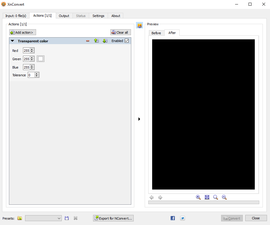

Its a piece of cake with XnConvert (see screenshot), but despite searching and trying, I wasn't able to get the same result as in XnConvert with NConvert: Simply replace with (255 255 255) with transparent color.

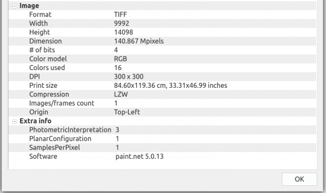

These are the properties of your attached test image:
Could you please post the properties of the original full-size image using XnView MP Image > Properties...
I am concerned that your smaller test image may have different properties.
You might be better making a crop of a small area of a full size image, and then ensuring that it is saved with identical properties to the original image.
You should also please ensure that your test image converts to transparent using XnConvert so that the test image is valid.

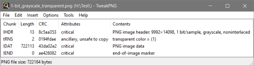

Result: 4-bit indexed with a 16-color palette and alpha channel transparency (1'006'671 bytes) - Optimize test_white_1.png with PngOptimizer (lossless).
Result: 1-bit grayscale with transparency (722'184 bytes)

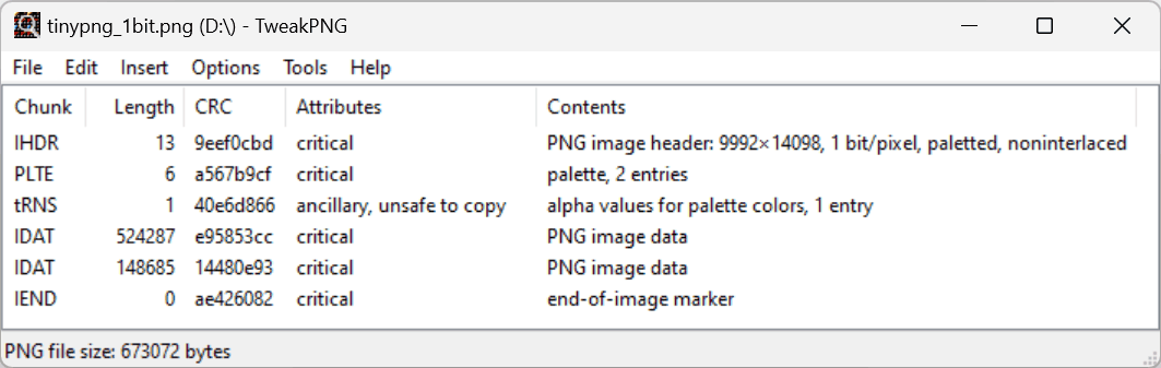

hm.. tinypng.com reduces 4bit with transparent index from 1Mb to 673kb
which can be resaved in xnviewmp as 32bit avif (523kb, 15mins) or webp (776kb, 2mins)

Wow, confirmeduser0 wrote: Wed Oct 16, 2024 6:29 pmhm.. tinypng.com reduces 4bit with transparent index from 1Mb to 673kb
And it's lossless.
