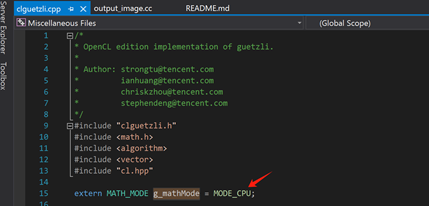

The solution would be (citation from author):
if you can clone&rebuild the source, you can change the default parameter of g_mathMode which is in the file clguetzli.cpp, change it to MODE_CUDA and rebuild it. (End of citation).
Unfortunately, I did not manage to compile it after 2 days of hard work. Lots of errors during the compiling process. Hoping for help now.

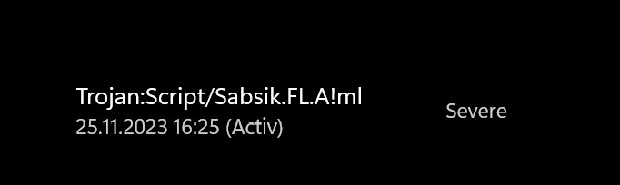

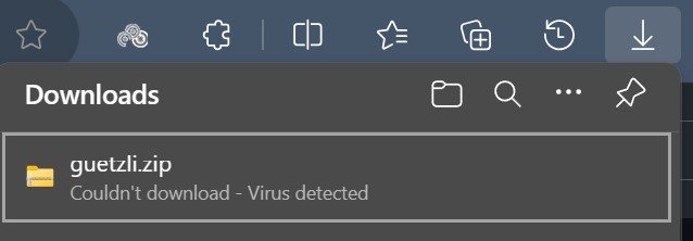

First problem:
I cannot download it because the latest Windows 11 with the latest MS Edge and latest MS Defender Antivirus finds a virus!
See below:
This is it: https://www.microsoft.com/en-us/wdsi/th ... ik.FL.B!ml
m. Th.
