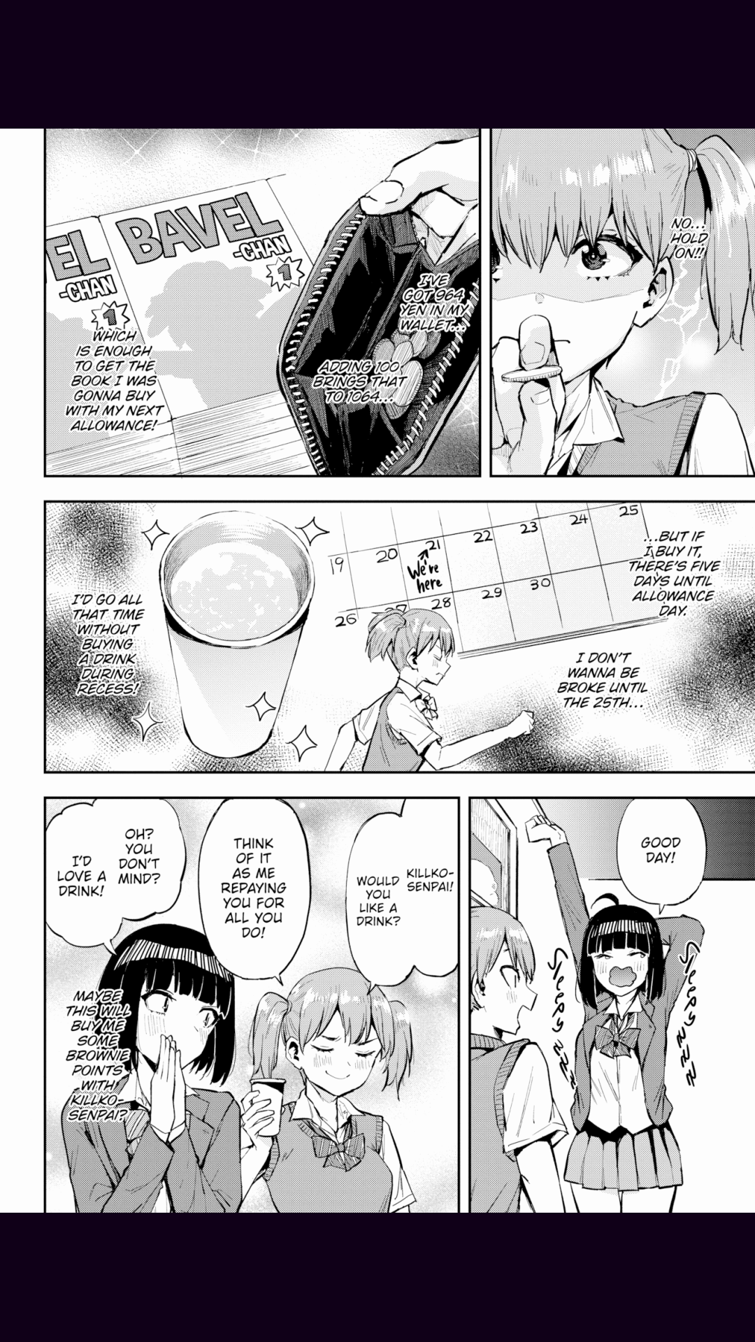

Not sure if this ongoing problem is going to be fixed in 1.6.2, but I realized that pictures are getting less detailed when they are get slightly zoomed out due to 'adjust height/length' settings. In various posts there are discussions about Lanczos implementation not correctly working, zoom levels resetting and so on. If you use 'open with system program' (F3 default) while viewing a picture, it opens with Windows Photo App, or in another use case Pictureflect Photo Viewer - in which both are correctly showing the image fine without blur.
To reproduce view all of them on a portrait format monitor (pivot turned 90 degrees) and view each of them in XnView and another image viewer of your choice (in my case Windows Photo or Pictureflect Image Viewer).
Any input on that? I also remember it worked fine on the 0.98.2 version of it in the past, but it seems not to do so when I downgrade now.
In the attachment I've attached samples:

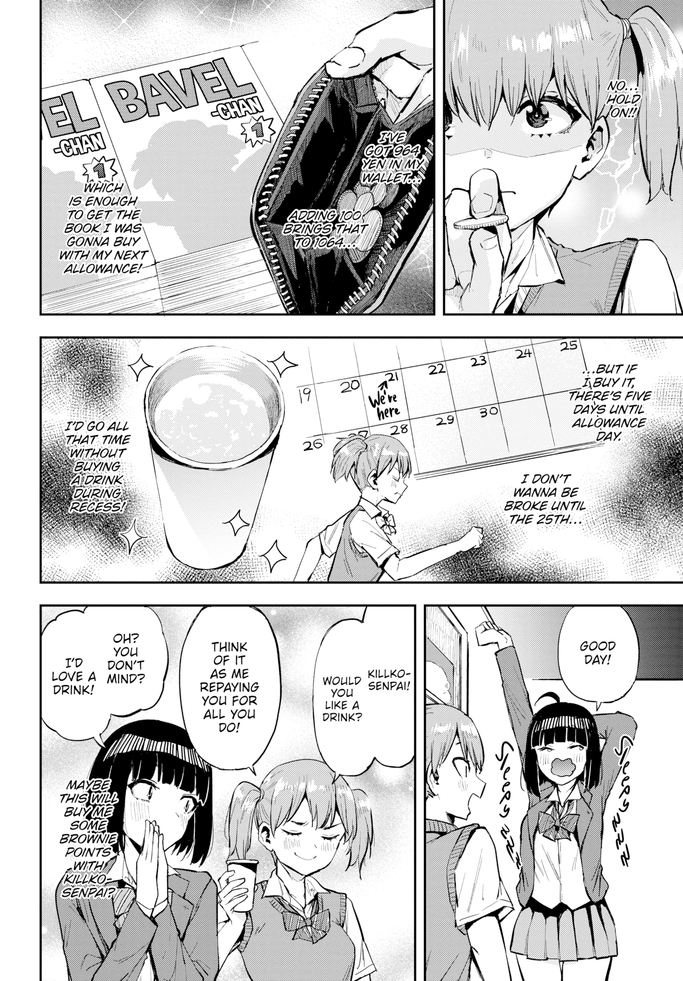

is the original file sample.
is a printscreen of the original file in another functional viewer than XnView (Printscreen was taken from a 1080x1920 monitor turned pivot)
is a printscreen of the original file in XnView - it's not a strong blur in this one it depends on image quality and size, but you can notice it on her left eye (top right panel) and in general the text getting slighty 'out of focus'.

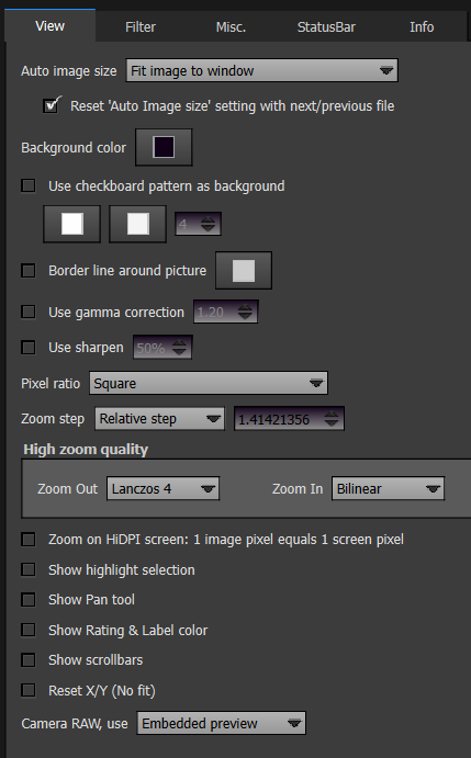

What do you have in Settings>View?
This was the setting I used, but it doesn't affect either way even when I choose another one like none, bilinear etc. The sharpening setting doesn't seem to have an effect either - after changing a setting I also close XnView and start again to be sure it applies.

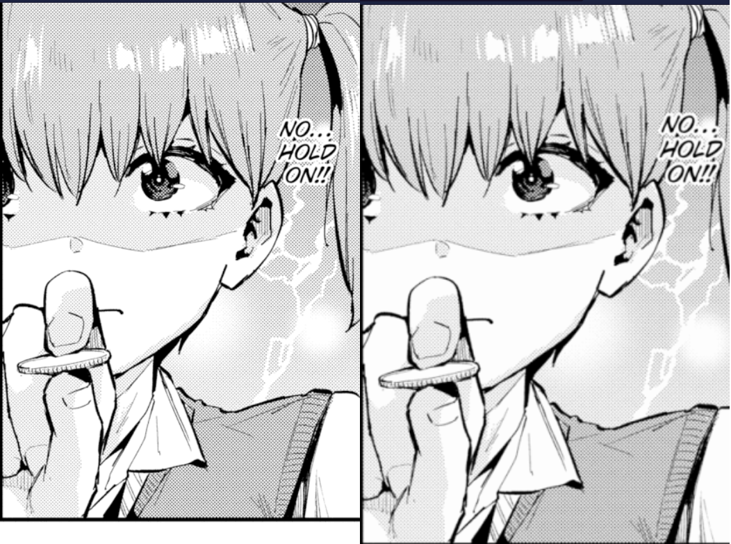

Also when zooming in the picture a bit, instead of out (by mousewheel or other zoom functions) it gets cleary sharper, as in there seems to be a problem with the sharpness of images as soon the zoom reaches below 100%.
-The left one is the 'XnView Original.png' zoomed in by mouse wheel one time and took a screenshot while fullscreen.
-The right one is 'Xnview Xnview.png'.
This comparison is also made by opening both pictures in Firefox as separate tabs and +/- adjust size and position (it's not perfect, but there is clearly more sharpening on the left image mostly on the text and eye).

I converted the 'XnView Original.png' with GIMP into 'XnView Original 24bit.bmp'. Opening this bmp image then in XnView does show it correctly.
(The 'XnView Original 24bit.bmp' image was too large to upload with +7Mb, this one is again the image opened in Xnview and screenshotted while fullscreen. Compared with the previous ones it does look correct).
So it seems to be a problem with low color depths? (The original picture is 8bit).
Posts: 46249
Re: 1.6.1 Unsharp/blurry picture zoom out
yes the problem is because it's a 8bits+colormap picture. 8bits grey or 24bits dont have this problem...
