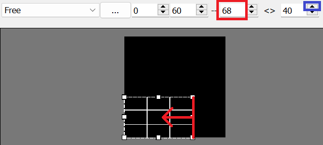

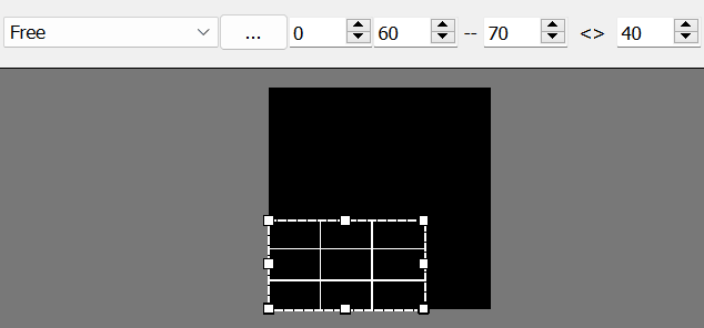

4. make selection with the following settings:
Issue A
5. increase height
width will decrease
same issue if mirrored (selection moved to the right image border) - increasing width will decrease height

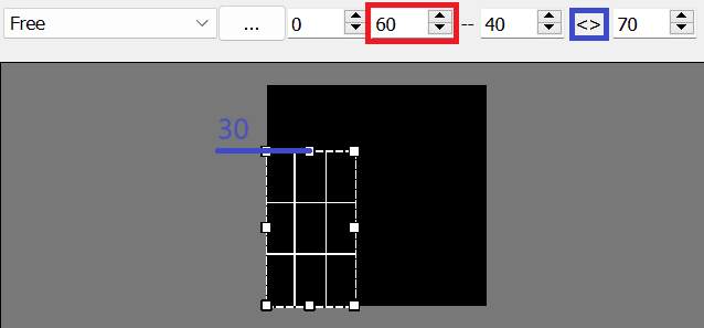

Issue B
5. press swap W & H button
selection width & height will be swapped
selection vertical position will not be updated in crop panel
Issue C
