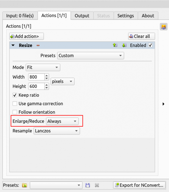

I presume that Pierre is referring to the Resize action in XnConvert 1.96:
Options are Always, Reduce only and Enlarge only.

I see .. that does not exist on the macOS Version, at least not there, and I can't find this kind of setting anywhere

Posts: 4395
Re: Cannot bulk resize to max-width or max-height
That is a an option in XnConvert 1.96, I understand Pierre to be asking if you think adding that option to XnResize would provide what you need?
You could if you wish install XnConvert 1,96 and test that option.

Just installed it and now I can see the option ... I am new, so I didn't have the time to make myself familiar with all the apps, I just picked the simplest solution for what I needed. I remember the XnView to be a good software from long time ago.
XnConvert seems to do the trick. Also on macOS. I only did a quick test, it worked, so I'll try later how I can add it to my workflow and how it makes sense. I did purchase another small app already, but will see now which one fits best. Thanks for pointing me to the right direction
