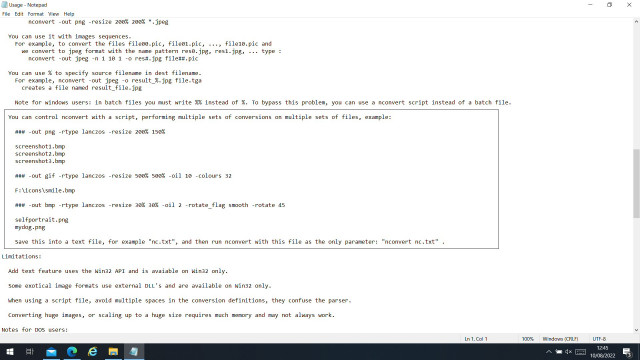

I've based it on examples from the readme files that came with Nconvert
Screenshot attached
I've used it to perform tasks on multiple files before now, but one command covering all the files (i.e. simply list all the files first, then the command) - works a treat

staylor43448 wrote: Wed Aug 10, 2022 11:48 am I've based it on examples from the readme files that came with Nconvert
The file you are referring to is from the wiki and I have seen it before, but didn't understand the ### notation then and haven't seen it defined since.
My feeling remains that, irrespective of how you run the code, you will probably need to define a variable that you can then use in a loop, possibly a For ... In ... Do ... that acts on a folder containing your source files to be processed.
Helmut originally created the NConvert support guides, so although your problem is not directly related to that notation, or may not be related, with his much greater experience with scripting NConvert, possibly he can provide some support? That will likely not be until much later in the day, though.

In the absence of a response so far from Helmut, I suspect after some investigation that the 'xxx' notation that I didn't recognise is
VBScript notation, which has in the past evidently to some extent been supported in XnView software. The following comments are based on my brief research.
VBScript would seem to have been for a long time a standard component in Windows, as a component in the Internet Explorer browser, and was no doubt so when Helmut wrote the wiki page. It has however long since been deprecated, although is still available and can be activated in even the latest versions of Windows.
If you are confident that the output you obtain from the first conversion is correct, then VBScript is presumably enabled on your computer, so the failure to run the second conversion in your script so far remains unexplained. If there is any doubt that it is enabled, you could search online for the way to enable it in your version of Windows, and then test again.
The alternative would be to simply create a batch file with each required conversion placed on a separate line.
