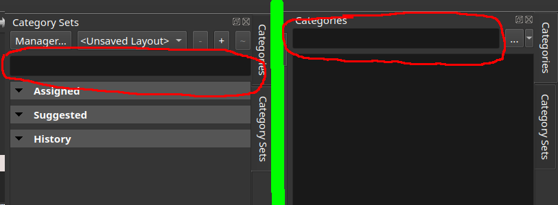

Here is a picture with screenshots of both the category and category set panes, with the bar I speak of, ringed in red. Surely you should be able to click on the bar, and write in it …though, given what you describe happening in the categories filter pane, I'd guess that nothing would happen.

I have just checked something on my Linux computer, where I have disabled the catalog (as I don't use it, waiting for some ability to regularly transferring the database to and from my Windows computer, rather than duplicating my strenuous categorising efforts), and there I am completely unable to select the bars in the categories and category sets panes, and right-clicking in the categories filter pane, gives the exact same result that you describe
…which is all as it should be, if the catalog is disabled. (except that "New Category" should also be greyed out, along with "rename" and "delete")
Thus I suggest you check Settings - Catalog, and see if the "Enable Catalog" option is checked. If that box is unchecked, then that is the answer to your problems. If so, just check it, and things should work properly, with no need for changing the folder where the database is stored, or using the ZIP-version.
(if it still doesn't work, then the previously mentioned stuff above applies)
…and speaking of Settings - Catalog, make sure the Base Path is "/" …unless you have a single folder, where (and in its subfolders) the images you want to catalog are, and you want to be able to transfer the catalog between multiple computers, in which case you can set that folders path. In any other case: Make sure it's "/"

Hallelujah! Without your persistent assistance I would have never looked back, but I did something in the settings (preferences on mac) under Browser/Catalogue that caused it to work. I now have predefined categories and am able to define my own as well.
I think it was changing the catalog root from '/' to the actual place where most of my photos are. I don't see any new file in there (a catalog file?) but now when I tag a photo (my terminology) with a category I can see the directory of the tagged files in a list back under settings/catalog. Such a strange tangle of procedures with very little documentation is a wonder and I have to say it is hard to trust an app that is so arcane. There are so many many many settings in the preferences that I have NO IDEA (and perhaps nobody has any idea) what they do.....
