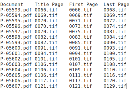

I have thousands of images that need to be converted and combined into multiple PDF files. Some of the images are used multiple times.
I have all of the .tif files in the same folder, and they are listed and organized in a spreadsheet. I want to use that file list and run a batch process to save myself hundreds of hours converting these files one by one.
I'm on Windows. Below is an example of the spreadsheet. These files are individual pages of many scanned documents. "First Page" refers to the beginning of a section. Example: 0066.tif-0068.tif is one document where 0066.tif is the title page of the document. 0070.tif-0081.tif is THREE separate documents combined into one, with 0070.tif as the title page for all three. So it would be 0070.tif-0072.tif, 0070.tif & 0073.tif-0074.tif, and 0070.tif & 0075.tif-0081.tif. 0069.tif is a single page document.
I need to specify individual files and/or ranges of files to be combined into single multi-page PDFs.
Thanks!
Thanks!
