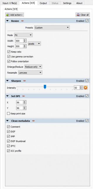

XnConvert conversion settings

Posts: 4396
Re: Using different input and output directories
The main difference is that the NConvert image pixel dimensions are not as expected, 500 x 500px?
Also the JPEG quality of the XnConvert image is 70, but the quality of the NConvert image is 85, the default value, as you don't have a -q 70 term.
