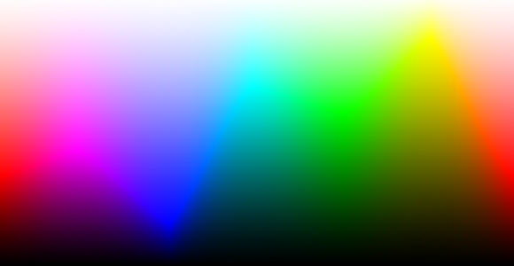

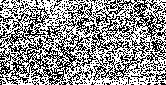

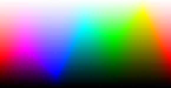

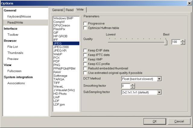

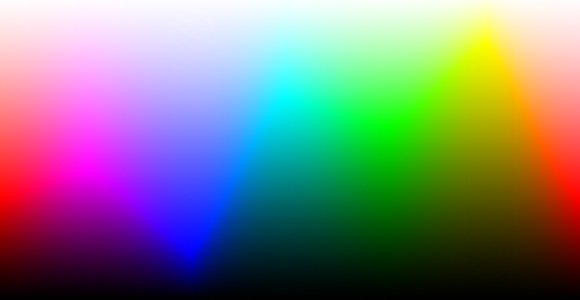

It depends. Let's say your JPEG that was previously saved without chroma subsampling i.e. 1×1,1×1,1×1 (best quality). Re-saving/re-encoding this JPEG with a SubSampling factor of 2×2,1×1,1×1 (default) inevitably introduces additional loss in quality. As mentioned before, the Use estimated original quality if possible setting only takes the (estimated) “quality factor” (1 – 100) into account.
Moderator & Librarian
Posts: 6512
Re: Basic understanding of "JPEG Quality"?
Original image<br />www.cambridgeincolour.com/tutorials/bit-depth.htm
Original image
Original PNG converted with XnView to JPEG (no chroma subsampling)
Conversion settings
Conversion settings
Converted JPEG resaved with XnView (default chroma subsampling)
Resave settings
Resave settings
Converted and resaved JPEGs compared with Image Comparer<br />www.softpedia.com/get/Multimedia/Graphic/Graphic-Others/Image-Comparer.shtml
