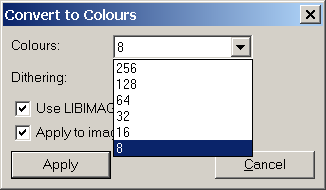

Please keep in mind that it usually makes a big difference whether or not you're applying dithering during color reduction.
I recently had to convert a large batch of images to 1-bit color depth. In my case, libimagequant yielded the best results. Although available in XnView and XnConvert, the current implementation of this algorithm doesn't allow you to go lower than 8 colors or to turn off dithering, …

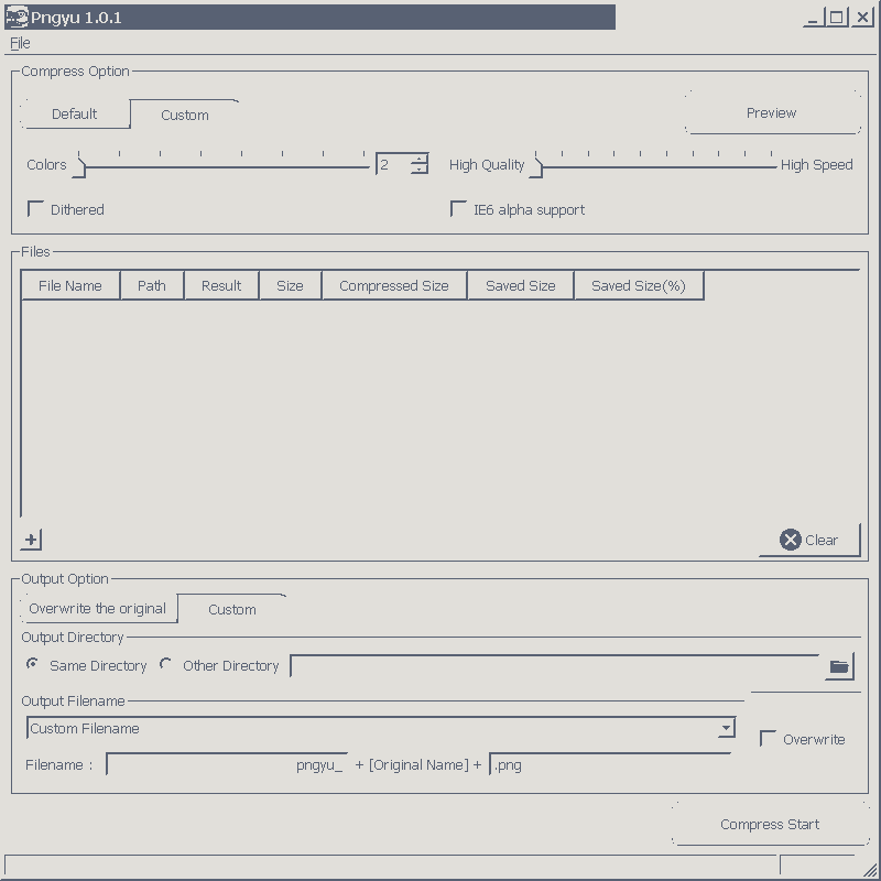

… which is why I gave Pngyu a try. My workflow (screenshot of Pngyu used as example):
  1. Convert the TIFFs to PNG using XnConvert or XnView:

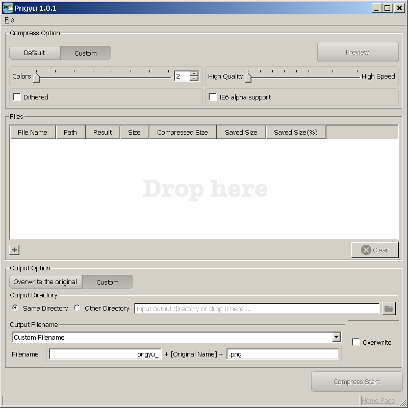

  2. Reduce the color depth of the PNGs to 2 colors using Pngyu:
  3. Convert PNGs to binary w/o dithering using XnConvert or XnView:
