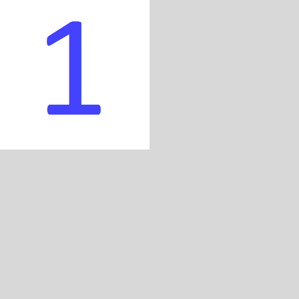

An illustration of how the watermark option mentioned above may be used to create a simple contact sheet:
The following code can be used to place an image 1.png at the top left of an existing canvas:
nconvert -wmflag top-left -wmfile Image1.png -out png -o Result.png Canvas.png

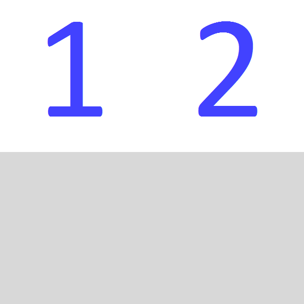

And the following code run in a batch file can be used to place two images on to the same blank canvas:
nconvert -D -wmflag top-right -wmfile Image2.png -out png -o Result.png  a.png

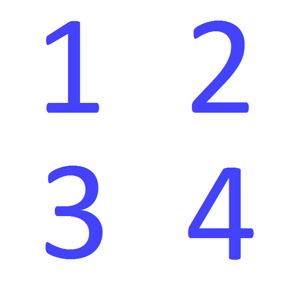

The following code can be used to place four images on the same canvas:
nconvert -D -wmflag bottom-right -wmfile Image4.png -out png -o Result.png  c.png

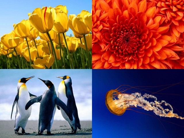

Here is a 2x2 contact sheet created from four Microsoft images using the above code:
Note: The posted image has been converted to JPEG format so that the size is below the forum attachment limit.
So NConvert can be used without too much difficulty to create contact sheets... :D
