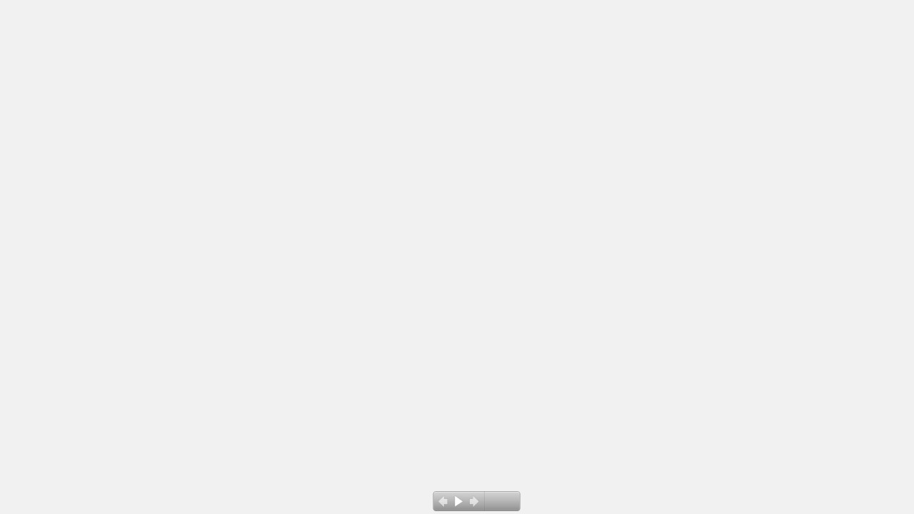

When I try to start a slideshow by double-klicking an sld file from outside XNviewMP, I get the attached screenshot: white background, no pictures, but arrow buttons for navigation. When starting the sld file from inside XNviewMP, the slideshow works, but no buttons appear.
