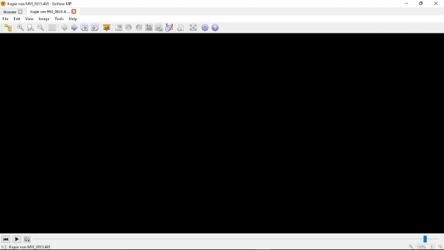

When viewing videos, the progressbar / slider is not in sync with the video.
Effect: Irritating/Unexpected behaviour
1. Start XnView
2. In XnView browser select a short video (e.g. .mov file of 10 seconds. The shorter the video, the better the problem can be seen)
Actual behaviour (bug): The video is shown in the preview. The progressbar/slider doesn't move for an instance although the video is playing, already. :bug:
Expected behaviour: Video and progressbar/slider should be in sync.
3. Wait till video is finished.
Actual behaviour (bug): When video is finished, progressbar/slider still hasn't reached 100% - it gets stuck at about 95%. :bug:
Expected behaviour: Once the video is finished, progressbar/slider should be at 100%.

Does anyone else experience this out-of-sync problem?

I just tried on my second computer (Windows 10 64bit, VideoMode=false)
The start of the video is synchronized, but the video ends while the progressbar/slider is still not at 100% (the progressbar/slider never reaches the 100%).

i can reproduce in view mode, seems to be a problem with QtAV
