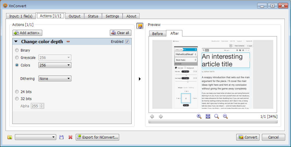

I don't think so if the optimum settings are used: I've now managed to use XnConvert to reduce your image to 256 colours and obtain the same 30KB file size as before:
from_XnConvert_256.zip
(29.24 KiB) Downloaded 140 times
I used the following XnConvert settings:
I'm not sure whether Dithering -- None and Filter -- None are actually the ideal settings but they give you a basis for any further tests you may wish to make.
Adding a Resize step seemed to increase the file size, which seems counter intuitive as the resulting image has smaller pixel dimensions, but possibly results from an increase in complexity in the image. Note that the 580 x 600 pixel size image you wish to create has a slightly different aspect ratio from your orignal image, and that selecting or not selecting 'Keep ratio' affects the image produced, so you may need to examine that. Edit: use 'not selected' to obtain the pixel dimensions entered.
Also note that the Resize step produces a 24-bit colour image, and so the reduction in colour depth to 256 colours must be the final step.
