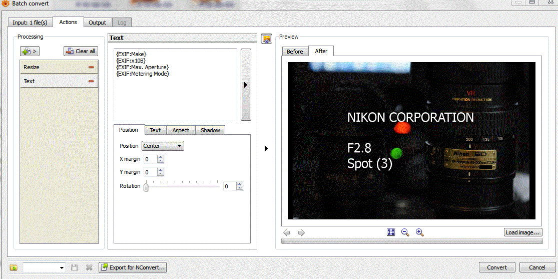

Re: Request : batch conversion : Add text : EXIF maker notes
you can use {EXIF:x10B} (x10B is the tag number of what you want)
- Posts: 6
- Joined: Fri Dec 23, 2011 11:48 am
Pierre,
Thanks for your reply. Perhaps it didn't work for me, attached is the screenshot I am attaching to show what I am doing. Note that Make, max aperture, metering mode appear except for the {EXIF:x10B}. I see the lensID, lens etc reported in the EXIF-maker notes section when image is previewed (am refering to third tab in the window, placed at left bottom quarter in default layout of XnViewMP). Is there something wrong?
Appreciate your help!
thanks
SKP
thanks
SKP

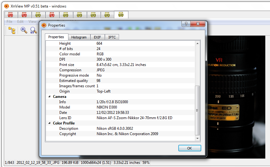

And what is the value?shrikrishna wrote: Just tried same image when opened using Picasa shows Full lens string... but Picasa is not for who know XMP/XnV![]()
- Posts: 6
Shows AF-S Zoom-Nikkor 24-70mm F2.8 ED
This is the complete name of the lens used to make this shot
thanks
thanks
Ok, i'll try to decode this lens too
Thanks shrikrishna for making the original request to Pierre
But yes Pierre must try to decode the LensID type you last uploaded for increased compatibility in XnViewMP
I see the LensID metadata in "Properties" XnViewMP 0.51 for your first picture you uploaded
