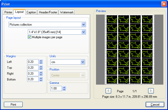

For a long time now, XnView can print an image several times on a page without the above trick.
Steps:
1. Select a picture in the XnView browser or open a picture.
2. Select "File >> Print"
3. In "Print" dialog, "Layout" tab, "Page Layou" are select "Pictures collection" in the drop down list. In the drop down list underneath you can select the size of the pictures.
4. Make sure that "Multiple images per page" checkbox is checked.
