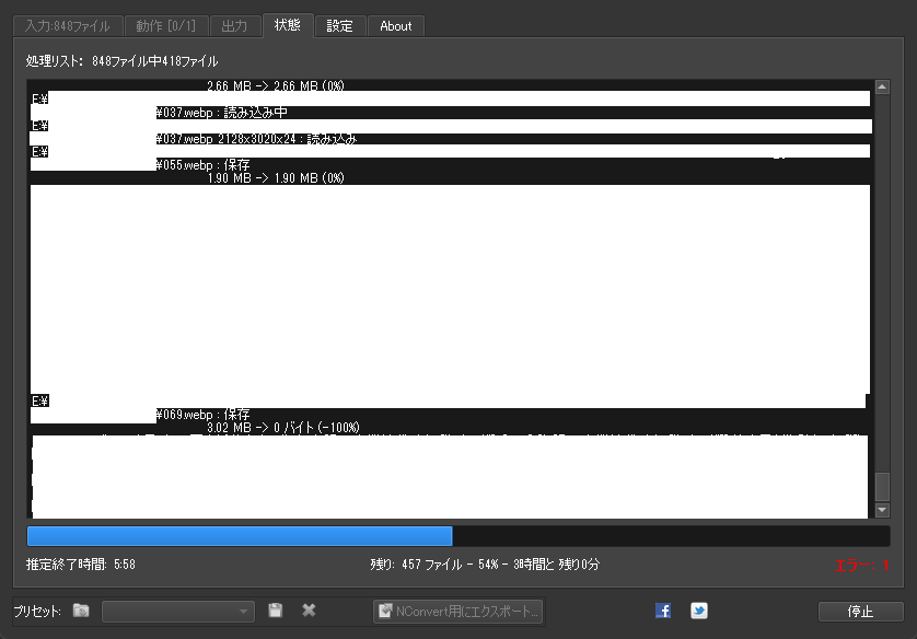

We've had a development in this issue, and fortunately, we were able to capture the moment the bug occurred. Although we've experienced actual damage, the fact that the problem has become clear is a silver lining.
The relevant part of the log is as follows:
E:\~ ~\069.webp : 保存(save)
・・・・・・・・・・・・・・・・・・・・・3.02MBー〉0バイト(byte)(-100%)
Other Japanese examples are... 読み込み中(Loading...) , 読み込み(Load Image)
In this case, not even a 0-byte jxl file is generated, and the original image is moved to the trash.
While identifying the root cause is our ultimate goal, our top priority at this point is to implement a preventative measure against file loss due to misrecognition. Therefore, ensuring these files are not sent to the trash is of utmost importance.
The "'delete encoded images' is on" feature has also caused normal file deletions due to unexpected encoder behavior in other instances. Details: viewtopic.php?p=204974#p204974
Therefore, we strongly propose adding the following behavior:
If a 0-byte file is saved during file generation.
In the event that 'delete encoded images' is enabled and the generated file is 0 bytes, the original image ought not to be deleted irrespective of the outcome of the encoding process.
Investigating the bug at this stage is like repeatedly trying to identify the cause while there's a risk of data loss, which is far too dangerous.
Implementing this is an unavoidable necessary step and should be considered an important investment for the "'delete encoded images' is on" feature.
