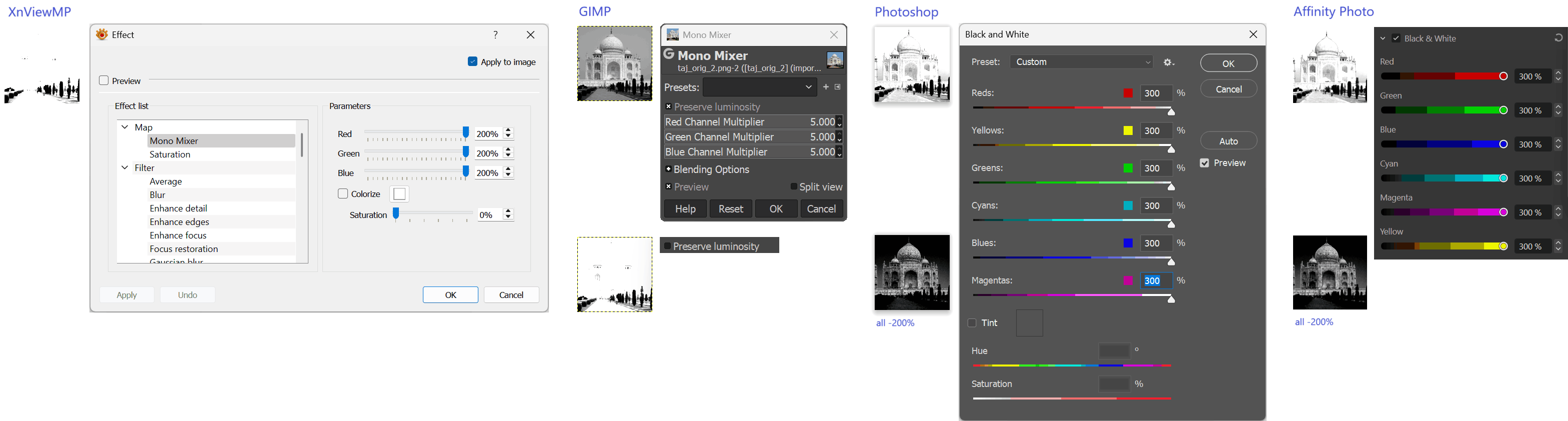

see instrument effect intensity at min/max in GIMP (☑ Preserve luminosity) and Photoshop
test image
  • add Preserve luminosity
    effect should be applied to RGB colors and Colorize Saturation
    Not sure if dedicated setting is required, maybe just update the calculations to match Photoshop
  • set default values to something usable, eg
    - RGB to 33%
    - Saturation to 20% (like in Photoshop)
