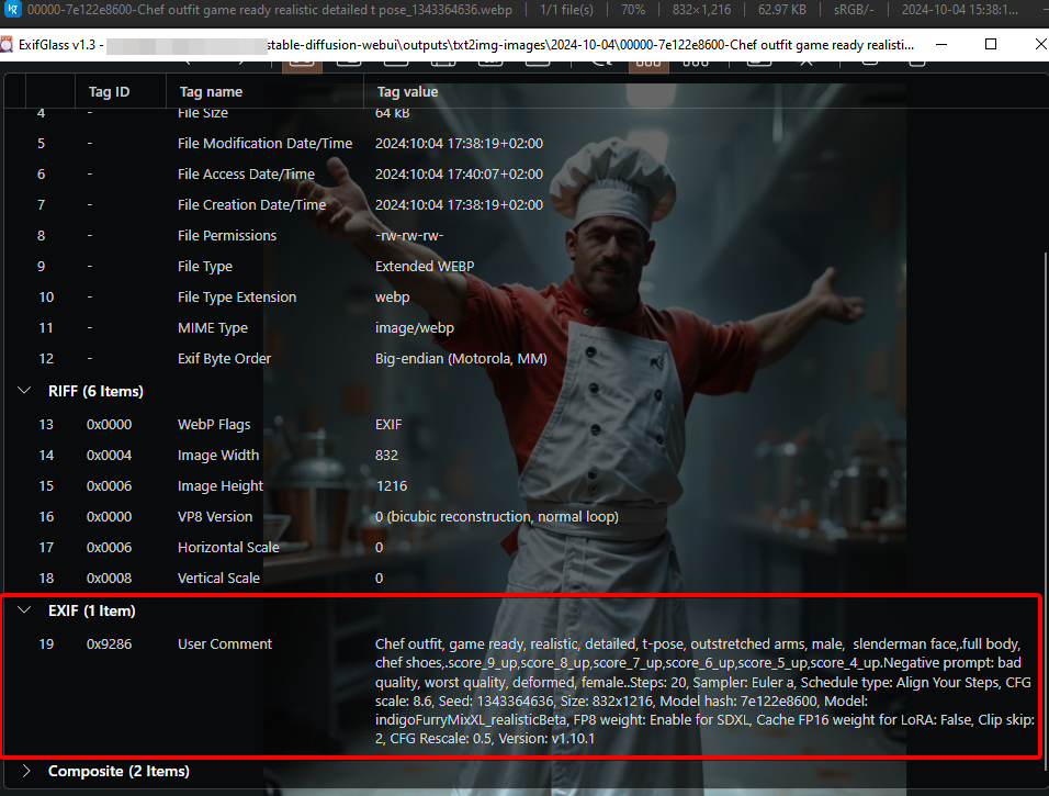

Just tested it now, converting this image to WEBP loses its AI prompt data.
I do know that WEBP can store comment data or exif data because in Stable Diffusion you can set it to use WEBP and checking the generated image that are WEBP, has the prompt data in it.

Otterus3dee wrote: Thu Oct 03, 2024 6:00 am I do know that WEBP can store comment data or exif data because in Stable Diffusion you can set it to use WEBP and checking the generated image that are WEBP, has the prompt data in it.
could you send me one webp?
I've attached a zip file with the WEBP generated in Stable Diffusion, I did make sure it does have EXIF data as you can see in this screenshot
