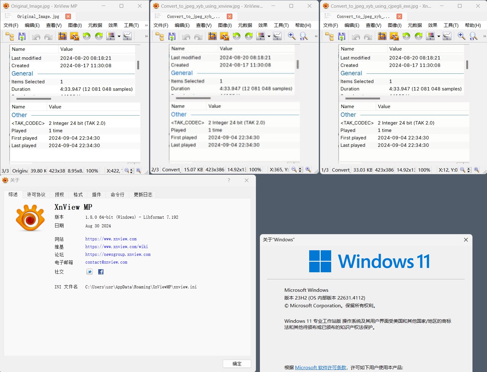

XYB cororspace images created by XnView MP using JPEGLI encoding are very blurry.
See the screenshot, below.
On the left is the original image.
In the middle is the image created by XnView MP (check Convert to XYB colorspace in Options).
On the right is the image created by cjpegli.exe, a command line tool provided by libjxl.
It can be seen that the quality of the image created by XnView MP is not good.
Windows 11 23H2 x64
XnView MP 1.8.0 64-bit
A sample image will be attached below:
sample.zip
(77.85 KiB) Downloaded 146 times

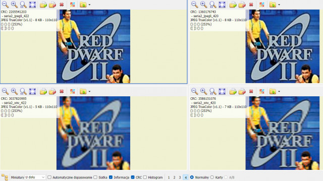

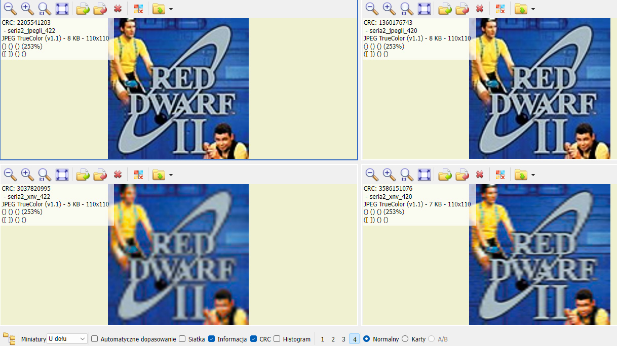

No, problem still is. Settings 422 and 420 give the worst compression against to cjpegli.
And 422 give 420 in output file, and 420 make 422 jpeg file.

xnview wrote: Fri Oct 11, 2024 6:43 am
Kadet wrote: Thu Oct 10, 2024 7:08 pm No, problem still is. Settings 422 and 420 give the worst compression against to cjpegli.
I have the same as cjpegli, it seems that you dont use --xyb
It doesn't make a difference if I used or not xyb in XnView — yesterday.
But today you are right, there is a quality difference whether I set xyb in XnView, I forgot to set xyb in cjpegli and now I have basically similar results (the difference of a few bytes is due to the newer version of cjpegli).
Sorry, I may have mixed something up yesterday.
