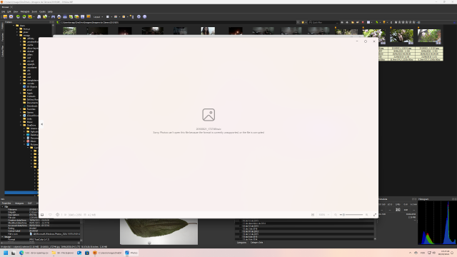

When converting some .jpg file to .heic using the program, Windows can no longer open the image. In previous versions this did not happen.

Any jpg file I try to convert, this happens. The resulting heic file can be opened and viewed in XnView, but any other app on Windows can't open it, like Photos, Paint, Affinity Photos or any other.

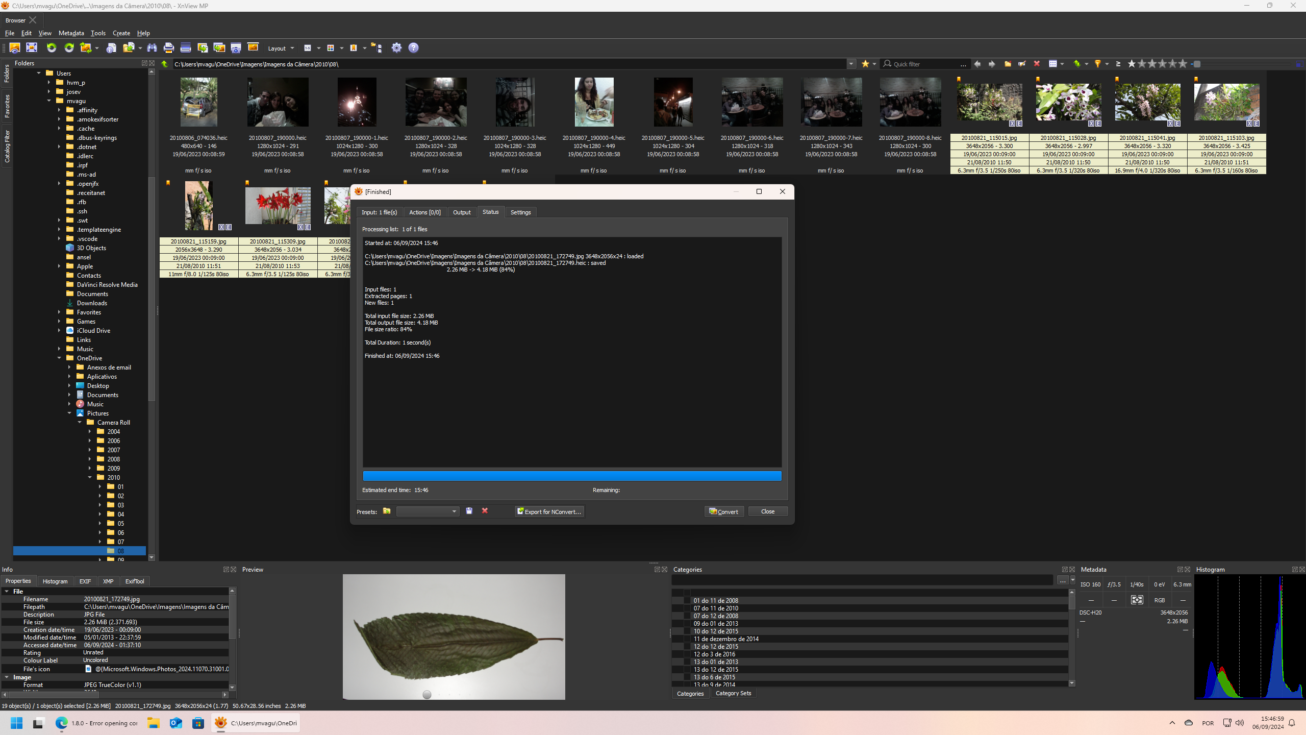

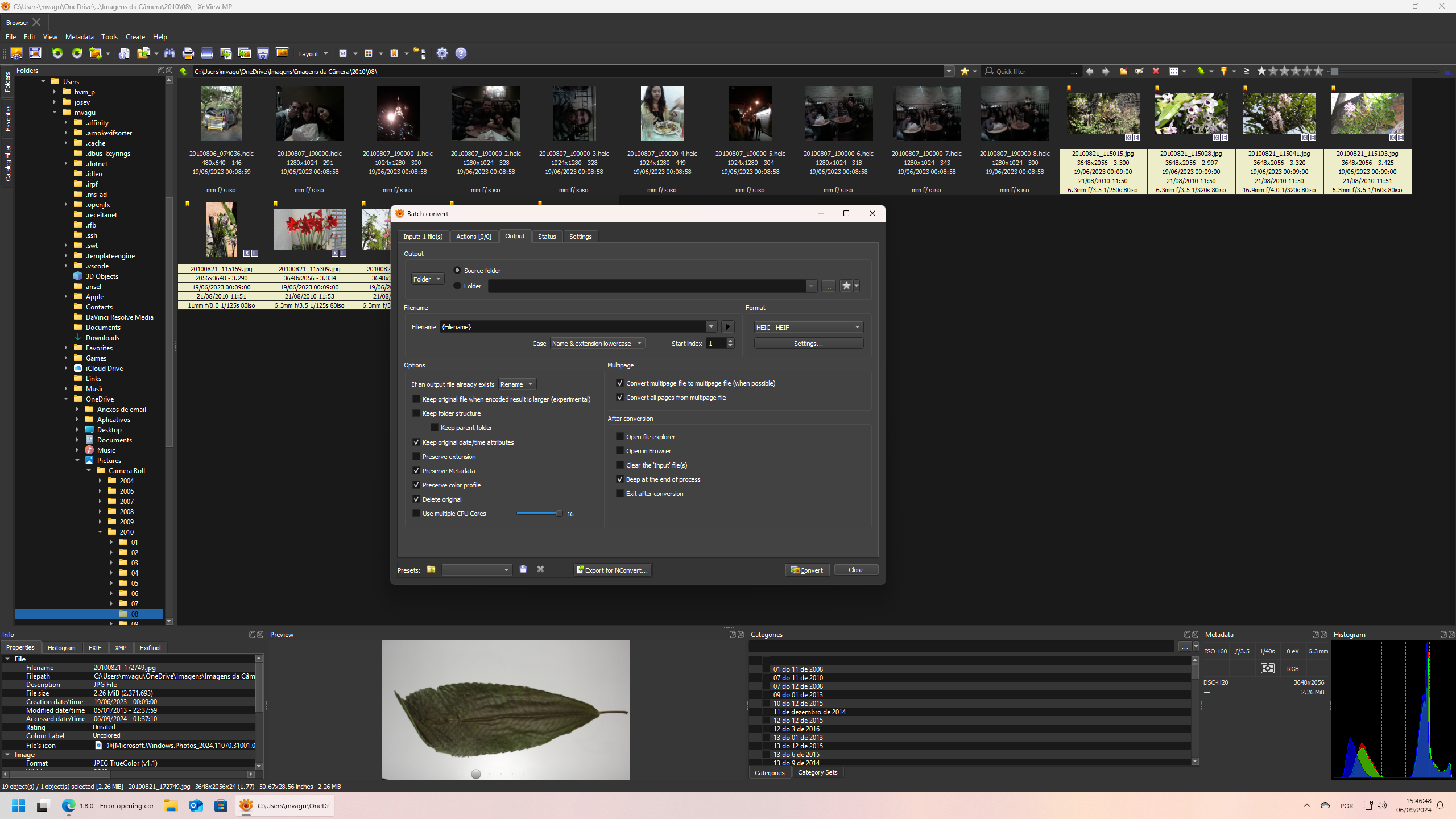

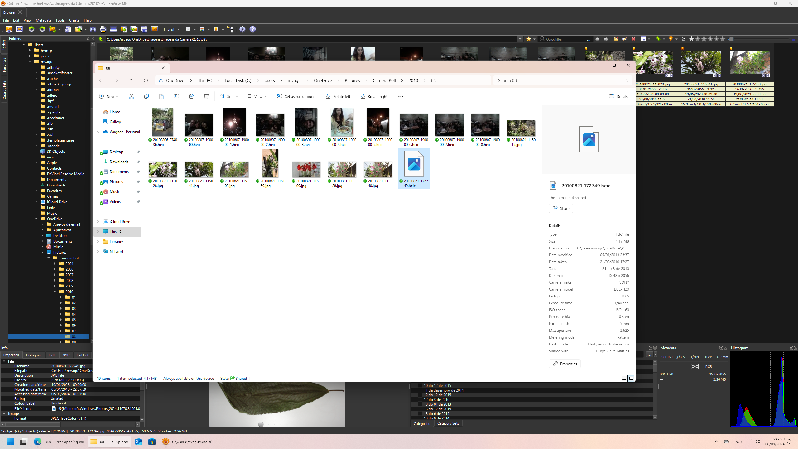

I just did some more testing here, and if I set the conversion quality to any value other than 100, the conversion goes through successfully. It seems that the problem only occurs in lossless conversion.
