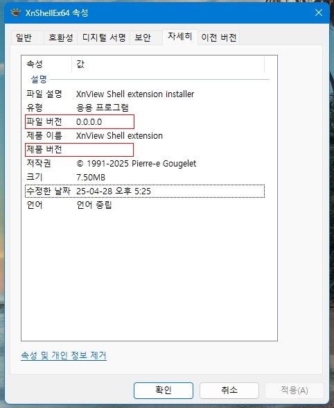

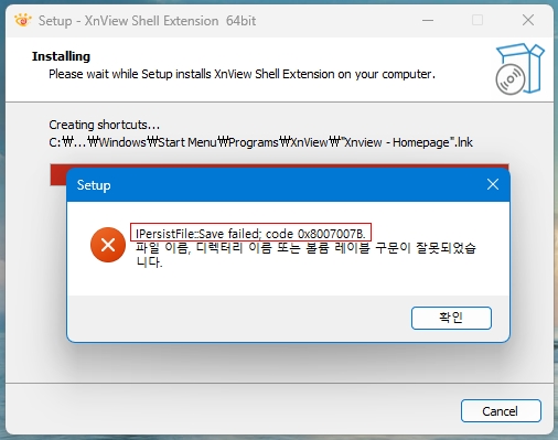

Re: XnView Shell Extension
I installed XnShell Extension (last rev 4.1.14) on a Win11...
but error message...below...(And file(XnShellEx64.exe) version info viewed "0.0.0.0"...)
IPersistFile::Save failed; code 0x8007007B.
(refer Attachment file...)
right, i fix itjdlee66 wrote: Mon Apr 28, 2025 8:33 am
