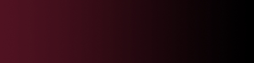

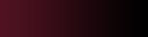

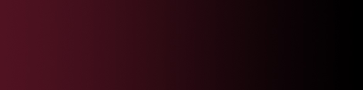

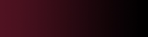

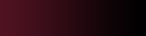

I'm surprised that there is next to no apparent color smearing with the XYB output, which by default has chroma subsampling. I picked the nastiest blue and red combination I could find, and I only saw a faint white glow. I wouldn't use this format because it relies on ICC to fix up the colors afterwards. This requires a recent version of an ICC engine. Old software like Photoshop CS2 or old FastStone show wrong colors. When it works, ICC (any) is sometimes an order of magitude slower to load. Irfan is very slow.
The benefit of this encoder is supposedly extra bit depth because it does intermediate calculations at a higher precision. So it an encode artifical gradients better. However, I don't see it. A 16-bit input gradient has significant banding. The cjpegli.exe doesn't seem to apply any dithering (jpeg output is very small). Dithered 8-bit input has the same overall banding in cjpegLI, Irfan and Photoshop. So saving from 16-bit directly seems to be a bad idea.
