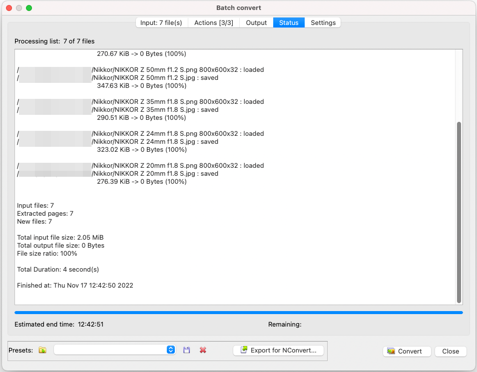

For the last few months however, I haven't been able to get any file from Batch convert, even though this has been working in the past.

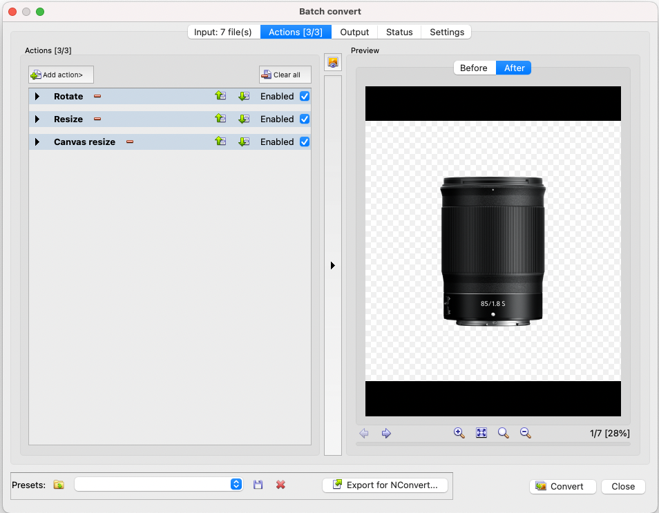

In this example, I am just taking PNG files, rotating them clockwise by 90°, resizing the canvas and exporting them as JPEG. Lately I've also tried to simply resize JPEGs.
However, when I run the batch I keep getting 0 Bytes (100%) result.
Try to get and provide more information. You have three actions. Leave one at a time and check each one: it doesn't work individually, it doesn't work in combination (for example, sequential resize).

Posts: 46251
Re: 0 Bytes (100%) on Batch convert
please change 'JPEG Guetzli' to JPEG

I had settled for XnView_MP-0.99.7-mac.dmg.
I tried saving as TIFF and it worked. And changing from JPEG Guetzli to JPEG / JFIF was also conclusive.
The latest software version should work too, as long as I don't use JPEG Guetzli.
Thanks very much!
