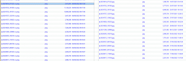

difficult because i do not want to upload 10mb files
09-08-2022 20-04-07.png (10.05 KiB) Viewed 1585 times

You could possibly post screenshots of the viewer File > Properties... display for a JPEG, and for the same file converted to PNG by XnView MP, and if possible another software that you say produces smaller output sizes...
You might also look at the PNG save compression level set, the default values is 6 and I don't think increasing the value to the maximum of 9 reduces the filesize very much.
I believe without checking that the PNG format supports alternative compression methods, and that the content of the image being saved may also significantly affect the size of the output file, with areas of uniform colour possibly compressing very well.
