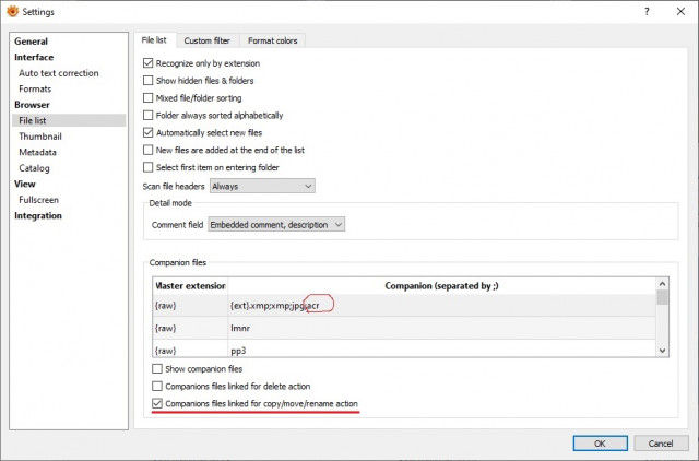

Here are my options.
2nd problem happens when i check "Companions files linked for copy/move/rename action"
When i drag this image thumbnail from XnView MP to Photoshop it tries to load ACR file as well.
1st problem happens when i right click on the thumbnail and select Open With > Photoshop
Then it opens thumbnail however ACR file located in the same folder does NOT load (Photoshop does NOT see *.ACR file so custom image settings don't update)

FKCapitalism wrote: Thu Jul 28, 2022 5:38 am 2nd problem happens when i check "Companions files linked for copy/move/rename action"
It's normal. When you drag&drop, 2 files will be used (selected file + companion file)
