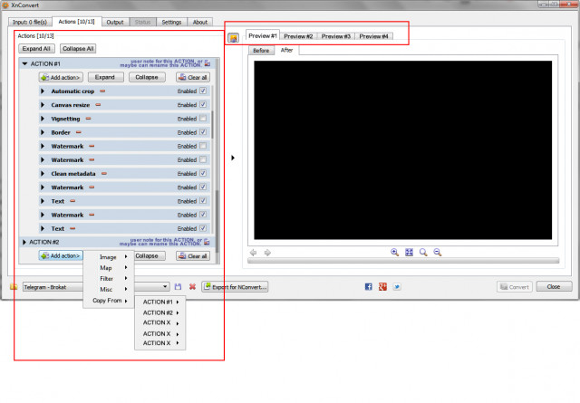

great, but how do you see the extended control panel to associate output/actions for each process, it's not clear for me.
Perhaps a better way is to create a group of action with output action

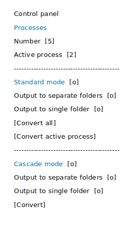

The first post in this thread outlined a way in which XnConvert might be modified to enable the output of alternative versions of the files that have been loaded, an enhancement that has been regularly requested in particular for possible web use. Other possible uses can also be envisioned.
The basis of the proposal is to add a new operating mode in which the program is run multiple times with different Actions tab and Output tab settings for each run. A key insight in developing the mode was that with the addition of suitable program controls, the existing Actions tab and Output tabs could be used to enter the settings required for each run.
The new operating mode would be enabled by selecting an additional option added to the Settings tab. The default value of the new setting would be unselected.
An important feature of the proposed new mode is that a user launching the program to use it in the existing way will see only the existing program interface, and will be able to use it without even knowing that the new mode has been added.
The new mode would be managed from a control panel:
Control panel.png (31.32 KiB) Viewed 1564 times
Key: [5] represents a value entered by the user, [o] a radio button, and [Text] a button.
Colour is used as a formatting aid in the absence of the aids normally available.
In the above control panel design:
Process refers to the creation of a set of output files when the program is run. The output files created will depend on the input files loaded, the Actions and Output settings entered, and the Settings tab settings.
Active process is the process to which the Actions tab and Output tab currently relate, on which the required Actions and Output tab settings for that process can be entered.
Setting up the program in the new mode would consist of first setting the required number of processes, then setting the 'Active process' to '1' and setting up the Actions and Output tabs settings needed for the first set of output files, then setting the 'Active process' to '2' and setting up the Actions and Output tabs settings for the second set of output files, and so on.
The proposed control panel design supports operation in either of two modes:
In Standard mode each process runs independently, reading the input files that have been loaded, applying the specified actions, and producing the specified output files. Options are provided to output the files created to a separate folder for each process, or all to the same folder. Options are also provided to run either all processes, or only the currently selected active process.
As well as allowing complete flexibility in operation, the design outlined would also allow a user who regularly runs a number of standard conversions to leave them loaded as separate Processes, allowing a selected process to be run immediately when required, without the need to load a saved actions script and set up the corresponding output tab.
In Cascade mode the Actions specified in a particular process are applied to the images created in the previous process, rather than to the files loaded on the Input tab as in Standard mode. For example, the actions applied in Process 2 are applied to the images that were created by the actions in Process 1, the actions applied in Process 3 are applied to the images created in process 2, and so on.
When different size versions of images are required for web use, this mode would simplify set up by avoiding the need to repeatedly set up actions already performed in an earlier process, and also minimise the program run time when converting a large number of files by avoiding unnecessary repetitive processing.
It was originally anticipated that the control panel required for the new mode would be placed on a panel to the right of the existing program window, which when the new mode was enabled would expand in width to create the extra space required. The vertical orientation of the example control panel above would be ideal for that location.
Another possibility, if there is a reason for preferring it, would be to place the controls required for the new mode on an additional tab to the right of the existing tabs that is displayed only while the option that enables the new mode is enabled. That would however mean that as the controls would not be displayed continuously and be accessible at any time, so the additional tab would have to be reopened each time that control panel setting needed to be changed. Operation could nonetheless probably be easily learned.
For considerations relating to the detail design of the Action and Output tabs when the new mode is enabled, see the section of the first post 'Design of the Actions, Output and Status tabs'.
It is believed that the proposed new operating mode would be a useful addition to XnConvert, would meet a currently unsupported need, and might be reasonably easily added since it might be implemented primarily by reusing and linking existing code modules.
A note on the detailed program flow in Standard and Cascade mode:
In Standard mode each process would run entirely independently, so Process 1 would read each loaded image in turn, apply the specified actions required, and then output the required file. Then Process 2 would be run, read each loaded image in turn, apply its own actions and output settings and output the required files, and so on.
In Cascade mode, intended to provide a simple way to create the 'web' images regularly requested, where the each image is required to be output with, for example, different pixel dimensions, the program flow envisaged is:
o Process 1 would load the first image, apply the specified actions and output the first required file;
o Process 2 would load the first image bitmap created by Process 1 (in place of the loaded file), apply the specified additional action(s) required and output the required (probably resized smaller) file;
o Processes 3 and 4 (for example) would each apply an action or action to the bitmap created by the previous action, and output the required file.
o When the first loaded image has been processed by Process 1 to 4 (for example) the second loaded image would be processed in the above way, and so on until all loaded images have been converted. So the program flow would differ from that of Standard mode but still remain simple.
I hope that is clear! I think the above proposal overall could greatly enhance the power of XnConvert, could have a clear interface that can be easily learned, would importantly use the existing Actions and Output tabs without modification, and would probably not be too difficult to implement.
