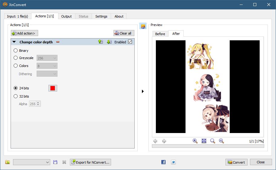

'change color depth' doesn't work for me. Whatever color I set to replace the transparency (alpha), the output always has white as the background.

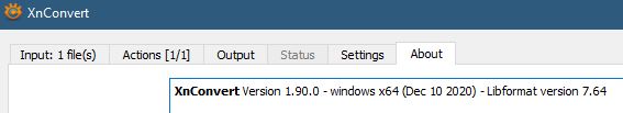

I'm using XnConvert Version 1.90

I can confirm the issue you report.
