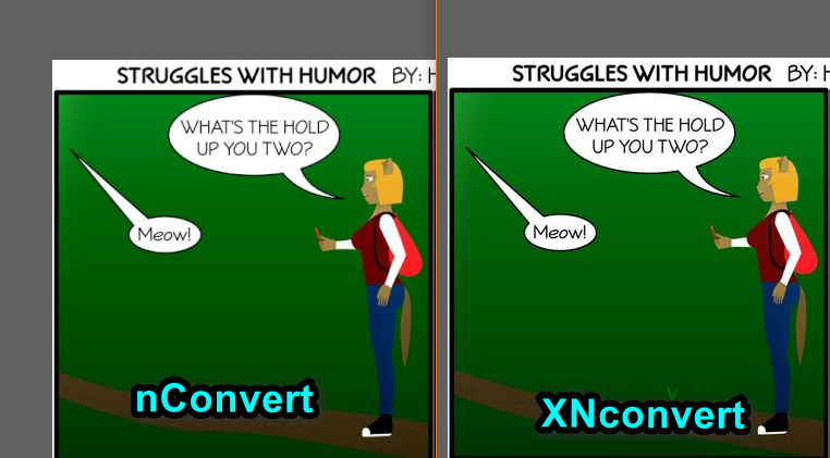

Hi, I am use to using Faststone Image resizer, but need to do resizing with bat files which it doesn't support.
When using nconvert however the image quality is substantially lower.
I've included a source attachment and the goal is to reduce it to 333px 333px [odd number's but that's just because this is a panel being taken out of context of a comic to avoid overly large images on the BBS]
Any help would be greatly appreciated.

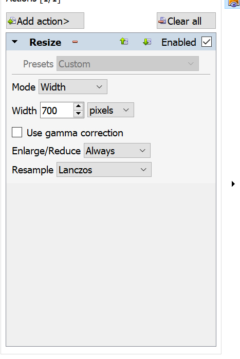

Could you post the code you are using?

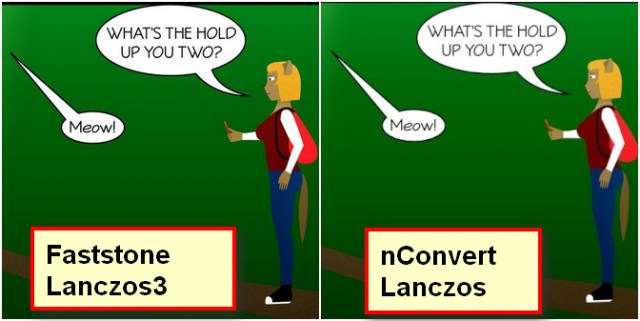

I don't have any immediate idea of what could be causing the quality problem, unless it is possibly simply the use of different JPEG quality values, but you do seem to be using different Lanczcos versions unless they are actually just different names for the same resampling method?
If you wish to experiment with different settings, you could possibly do it more easily using XnView MP GUI software, where you could change settings and see the result immediately... When I downloaded your source file and had a very quick look, the unsaved result seemed similar to your NConvert output.
Edit:
If you are using a bat file because you need do batch convert files, you might also consider the possibility of using XnConvert (or XnView MP Batch convert).
And if you wish to try different resampling options, and also possibly other options such as applying a filter to the resized image, you can very easily preview the effect of different actions using the preview displayed in XnConvert.

yes they are different, as I can't seem to find Lanczcos3 in nconvert at least not using the -help command or readme files which seems to be the only real documentation.
nconvert -out jpeg -ratio -rtype lanczos -resize 700 0 -o %%_SWH_W700_nuttytales.net.jpg "%~1"\
I don't need to do batches I need a single image to be automatically renaming and converted to different sizes for each new comic for all the different sties.
So I need to take a source file and than have it resized to about 10 different sizes all with unique names, which is why I want to use a .bat file to do it.

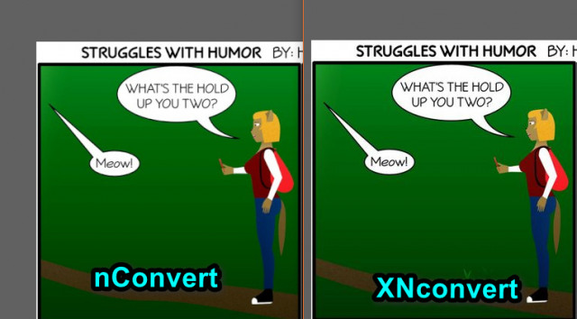

I just tired using XnConvert and it produced better quality than nConvert using the same settings?

On the assumption that Lanczos3 is better than Lanczos, I was going to suggest that you try finding the Lanczos3 plug-in in Faststone, and then try using it in NConvert, suitably renamed and with the NConvert plug-in disabled by, for example, renaming it. That would require that both plug-ins are the same bit depth, NConvert is available in either 32-bit or 64-bit versions if needed. Or maybe it can be downloaded directly?
One reference from a quick search: Lanczos3 algorithm as a way to produce better image downscaling.
