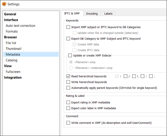

I'm in a process of replacing Adobe Bridge with XnViewMP 0.96.5.
There are the Settings>Metadata>IPTC&XMP (snapshot below) and I'd appreciate your help to set it up in a way that XnView and Bridge can coexist in SYNC.
So, what are the proper "Metadata" settings that would allow XnView to read/write ALL metada from/to Adobe Bridge (and vice-versa)?

you need 'export DB category', 'export rating/labels', i think that it's enough

And in order to XnView read the metadata/categories from Adobe Bridge, should I also set "Import XMP subject or IPTC keyword to DB Categories"?
And the option "update or create XMP Sidecar"?
Also, "Write comment in XMP"?
I'm just double-checking with you the "minimal" settings that would make what I categorize in XnView be seen in Bridge, and vice-versa.
Would a complete "sync" of metadata between XnView and Bridge be achievable?
After this initial setup with your directions, later I will post here my experience from practical usage.
Posts: 46236
Re: "Metadata" settings that allow XnViewMP to read/write ALL metadata from/to Adobe Bridge? I.e. Put them in sync.
cadu wrote: Mon Aug 31, 2020 2:12 pm And in order to XnView read the metadata/categories from Adobe Bridge, should I also set "Import XMP subject or IPTC keyword to DB Categories"?
Yes enable it
Bridge use XMP sidecar?
