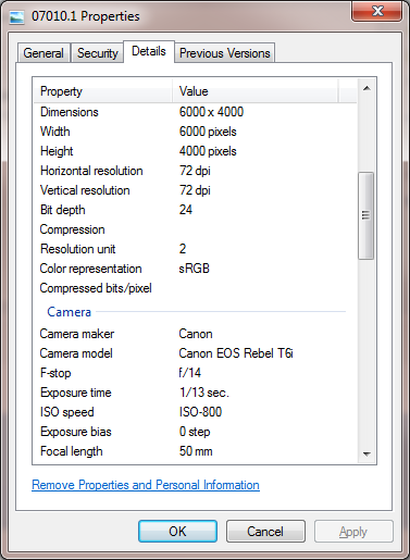

I'm not sure what the q-factor is. Quality of the images are 100% from the camera and sub-sampling should be 2. I've adjusted the command line to:
-out jpeg -dpi 300 -subsampling 2 -overwrite -no_auto_ext
Now my test file instead of 1.84 MB is 2.28 MB which is closer to the 6.09 MB of the original file size. Meta data is attached but I'm not sure what else if anything I can adjust on the command line to keep the original file size. Going from 6.09 MB to 2.28 MB makes me believe there has to be some kind of quality loss but if I add -q 100 to the command line the file size goes up to 10 MB.

- Attachments
- updated-meta.png (29.36 KiB) Viewed 11183 times
- original-meta.png (33.86 KiB) Viewed 11183 times
