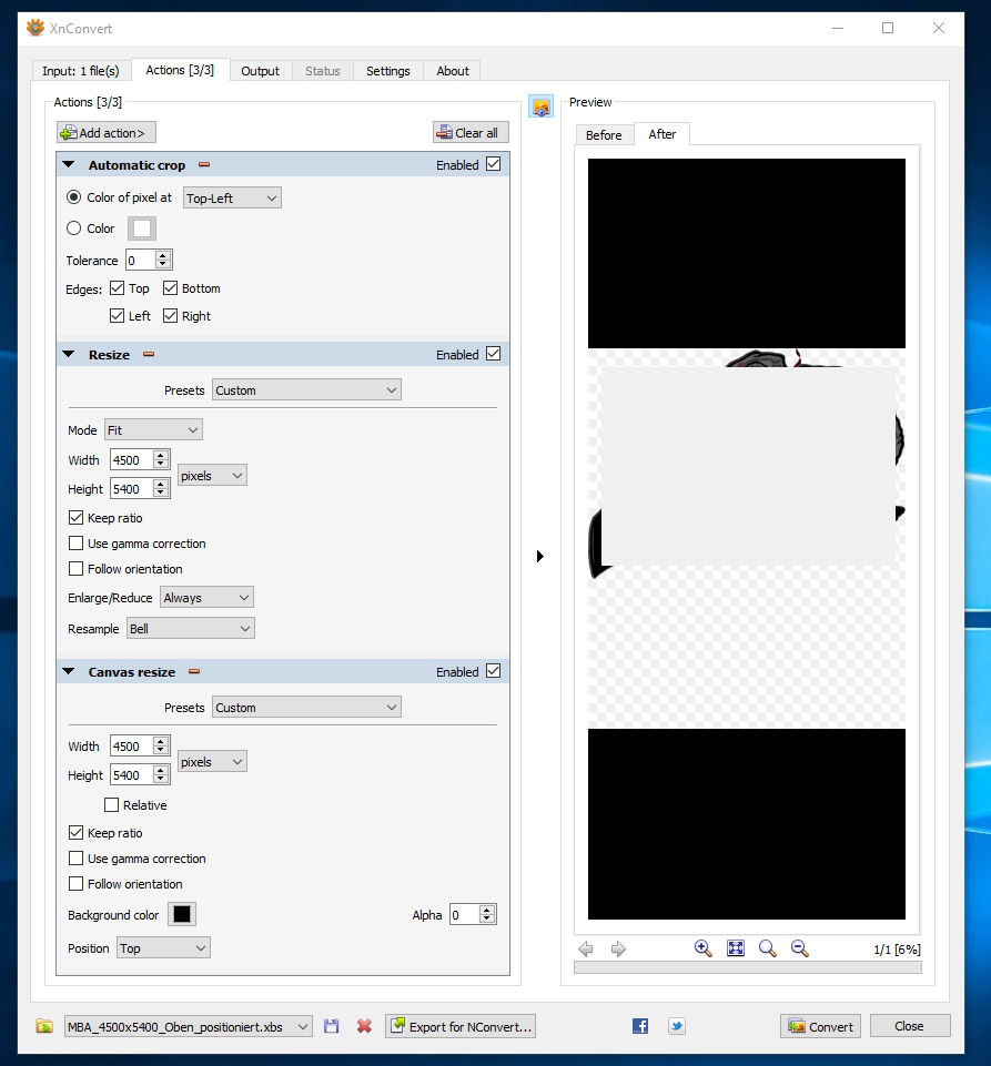

Hello I have a svg file that I want to position on a canvas of 4500x5400 pixel with the most possible
width of the picture what is possible with keeping ratio what I have reached with the first two actions
(you can see it in the picture).
Finally I want to position my picture in the upper area of the canvas but NOT on the highest top position.
I want to have a margin to the top. But in the Canvas resize selection box it's only possible to choose
Top, Top right, Left and so on.
So is there a possibility to set a margin to the choosed position?:
For example I choose position Top and 50 pixel margin or choose Left and 10 percentage margin.
Here a picture what I have done (rectangle over image because I'm not the copyright holder):

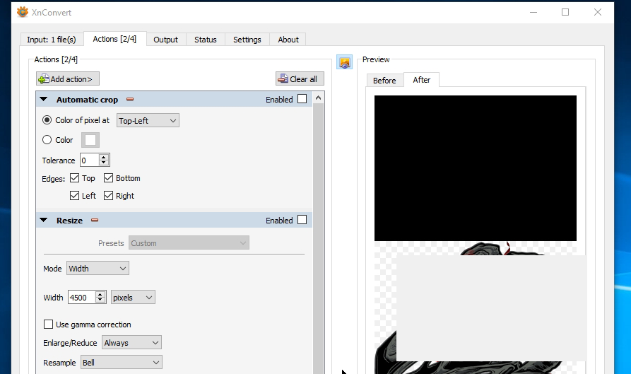

Yes, I find now a way to use the Watermark action and to do all in XnConvert,
but I have a problem with the Watermark action:
As step one I import my svg and do only the first two actions (Automatic crop and Resize
(Mode: Width, Width: 4500 pixels)). Then I convert to png.
At second step I import the 4500 pixel png (and height pixel ratio accordingly) that was created in step one.
Now I do only the Canvas resize (4500x5400 pixel) and the Watermark action.

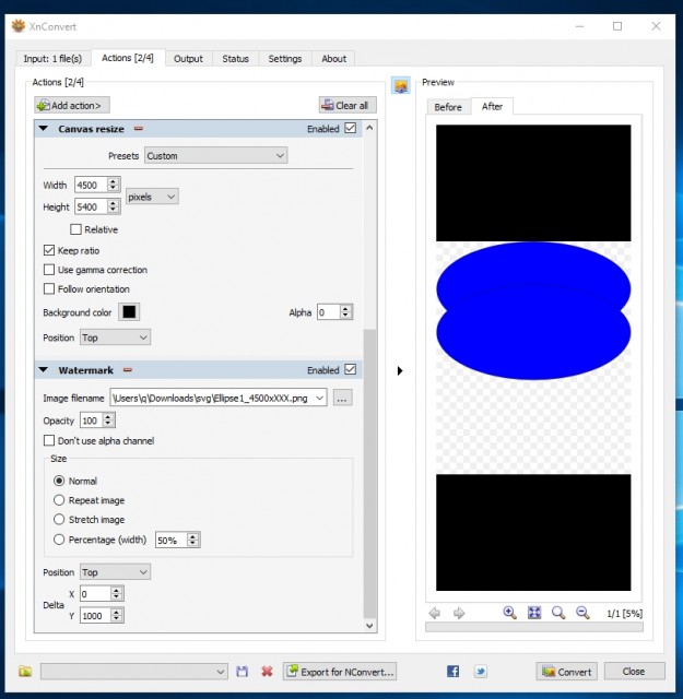

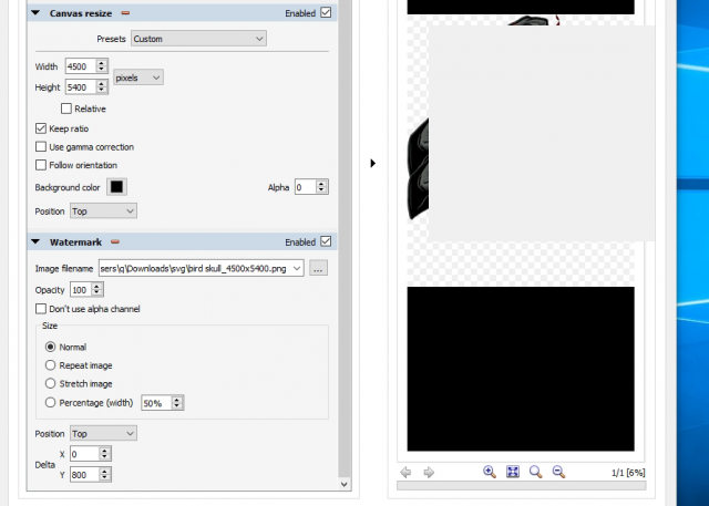

But the last problem is, that the Watermark action doesn't work as I supposed:
In the Watermark action I set Position: Top and then to move away a little bit
from the top a delta of 800 for Y.
But instead of only moving my picture a little bit down I get a second picture.
You can see it in the second picture.
So why I get a second picture instead of only a moved down picture?
And how can I prevent to get a second picture?
First I do this with my svg file and convert it to a png file:
Then I import the png file I made in step one and do this two steps:
Posts: 4397
Re: Canvas resize: How to set image margin to canvas in pixel/percent?
Your images between Img tags didn't display again, and I couldn't easily see how to edit them so that they were directly visible in your post.
Would you please post any further images as attachments, referring to this tutorial if necessary.
I need to look more closely at your post later as I am still finding it hard to follow.
Are the light grey areas in the screenshots parts of the image that you are obscuring because you don't want them to be visible, or do the images show what you actually see yourself on the screen?
And if the early steps are working correctly, can you reduce the problem to the final watermark step which is not producing the result you need, and ideally provide test images that can be used to illustrate the problem, not necessarily the files that you are using now?

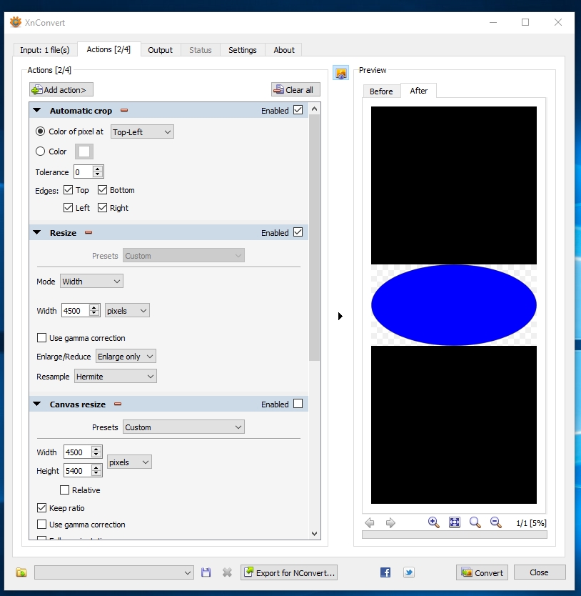

In Illustrator I created an svg with an ellipse image.
As step one I imported it in XnConvert and have done the Automatic crop and Resize action and converted to a png file:
As new input I took the png from step one and done the Canvas and the Watermark filter:
I set a delta of 1000 for Y to move the image down from the top,
but I then get two images instead of one a little bit down from the top.
Ok, I think now I understand why this happens. Because the Watermark is a second image.
And only the watermark image can be moved around.
Or it would be great if there were a Delta setting also for the Canvas resize action in one of
the next versions of XnConvert.
