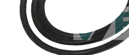

I have written a utility that calls Nconvert in shell commands. It works, however the images white space causes the converted WATERMARK'ed images to be partially invisible. That is the watermark partially is hidden by the white space.
When I use the UI of XnConvert on the same, I see that immediately upon opening the original image has a checkerboard background on the image. The watermark images appear correctly on these. I looked in XNconvert fpr options and I can't find how it does this.
Is there are a way to put the checked background or (something else ) on the COMMAND line options.
I tried "-back g" but it had no effect.
I need to find this soon......
Thanks for any help.
Phil

Hello, thanks for your response.
My question is more about Background. When I see a raw image, the back ground is white. Now, when I open that image with Xnconvert (the UI) it does this:
(See the image attached.)
XnConvert places a pattern on the white space. Is there a way to do that with the command line utility NCONVERT?

HI, thanks again.
I don't know what you mean "Exported". That is Windows shell command I am using as a test.
Maybe it is the image viewer I am using. Do you see how that corner of the watermark is "gone"?
Still, if someone knows how to use the TRANSparency commands on the command line, that would be very helpful.
Thanks again.
PD
Thanks again.
PD

The problem is that the top-left part of the small image on the right is white rather than clear, presumably?
It looks as it the 'watermark' image is behind the main image, possibly you need to reverse the images so that the watermark is in front, if that makes any sense? You could possibly try reversing the 'watermark' and 'main' files in your script and see the effect.
So you could try replacing your existing code:
"C:\Program Files\XnView\nconvert.exe" -o 1236_FLZ.png -out png -ratio -rtype lanczos -resize 1024 1024 -wmopacity 40 -wmflag center -wmfile FLZ_LOGO.png FLZ123.PNG
With this code:
"C:\Program Files\XnView\nconvert.exe" -o 1236_FLZ.png -out png -ratio -rtype lanczos -resize 1024 1024 -wmopacity 40 -wmflag center -wmfile FLZ123.PNG FLZ_LOGO.png
With this code:

Re: Watermarked images lack full transparency
No switching the files does not work. The entire image is cropped to the size of the watermark. No not right.
Yes, the watermark is placed in front and is transparent. That seems to work.
But some of the watermark is become lost (covered??) in the white space, as I showed in the image. The left corner of the transparent watermark was missing.
Right, well I thank you for your many answers and ideas. You have have helped me.
You know, I think it may be working as expected now.
But, there is a real problem in what image viewer is used. The new Windows 10 image viewers are worse than the old Paint program.
(how does Microsoft constantly makes things worse?)
It is the new Win 10 viewer that shows the watermark partially missing (in my attached image). In the old Paint program and the Xnviewer, the converted image looks pretty good. Although. I need more transparency for the watermark, that watermark is completely visible.
Man, this is complicated.
