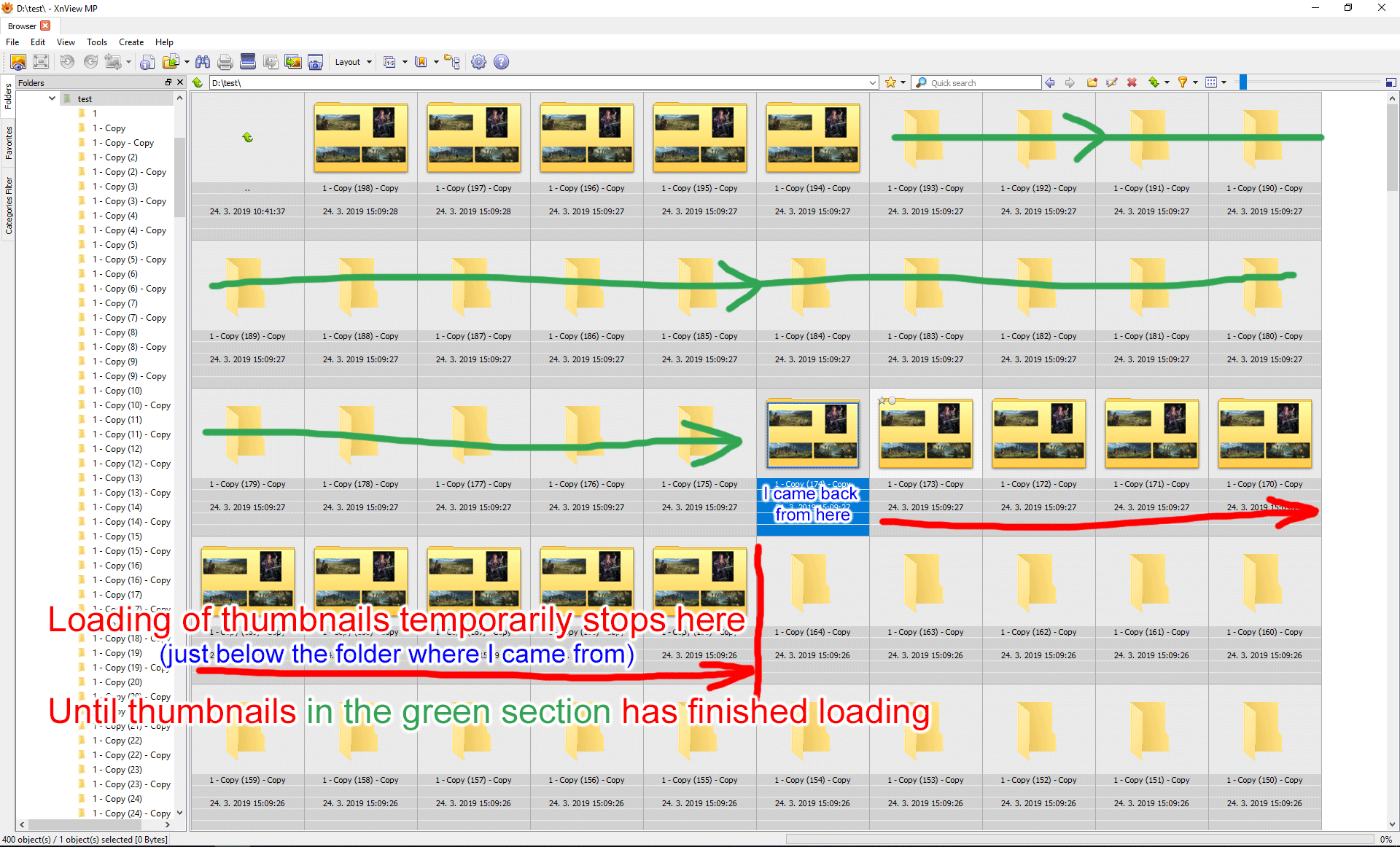

I came with an idea why some folders appear after some delay (which is observed as folder blinking). When I return from some directory, you probably give order to plot the first directory (with all thumbnail in it), then all directories behind the folder I came from (including). Since I have many folders in the current directory, it takes some time until all folders up to the end are prepared (loaded from a database). Only then the folders in between the first one and the one I came from are loaded from the database. In my current view I cannot see all folders, I see only few of them. Therefore, to my observation, they load instantly. Unfortunately, it takes some time until the last folder from the list is loaded. Until now, no thumbnails were loaded for directories between the first one and the one I came from. When they appear, I see it as a delay. It is just my guess.
Below is a screenshot capturing folder drawing sequence. In a magenta-framed area the folders (with image thumbnails) appear with a delay. In the meantime you can see these open folder icons which will be replaced later by folder icons with thumbnails.

Is it possible to have the subfolder? Which sorting do you use? do you use thumbnails caching?

Post by Milan » Mon Apr 15, 2019 4:14 pm
xnview wrote:
Mon Apr 15, 2019 1:29 pm
The folder you see above was created for demonstration purposes. Its size is 2GBs, but because all subfolders contain the same set of images, it can be compressed to a small 6MB RAR archive. I uploaded the RAR named "test.rar" here: https://spaces.hightail.com/space/oCAfez5YKQ
I use sorting by Date (Descending). But I tested also regular sorting by name (Ascending and Descending) and the blinking behaved the same.
Yes I do. These are my program settings (I think I use defaults except a thumbnail size):
[YES] Enable catalog
Compression: Lossless (ZIP)
Width: 192px, Height: 144px
[NO] Max size for cached thumbs
Mem usage for db engine: 100MiB (tried 2000MiB, no positive effect)
[NO] Check integrity
I use the portable version of XnView MP (64bit). The one you can download as the zipped program folder from your website. I tried today to extract XnView MP into different folder and start with clean "profile" (settings, cache). The folder blinking behaved that same on my test folder.
When I disabled the catalog (cache), closed the program and started it again, the drawing sequence of folder icons with a thumbnail view was different (see screenshot below).
Thumbnail loading sequence when catalog is disabled
Posts: 31738
Re: Blinking folder icons
Post by xnview » Tue Apr 16, 2019 2:10 pm
Ok, i understand now. The thumbnail creation starts on selected item, so you have a delay for thumbnails on items before selected item.

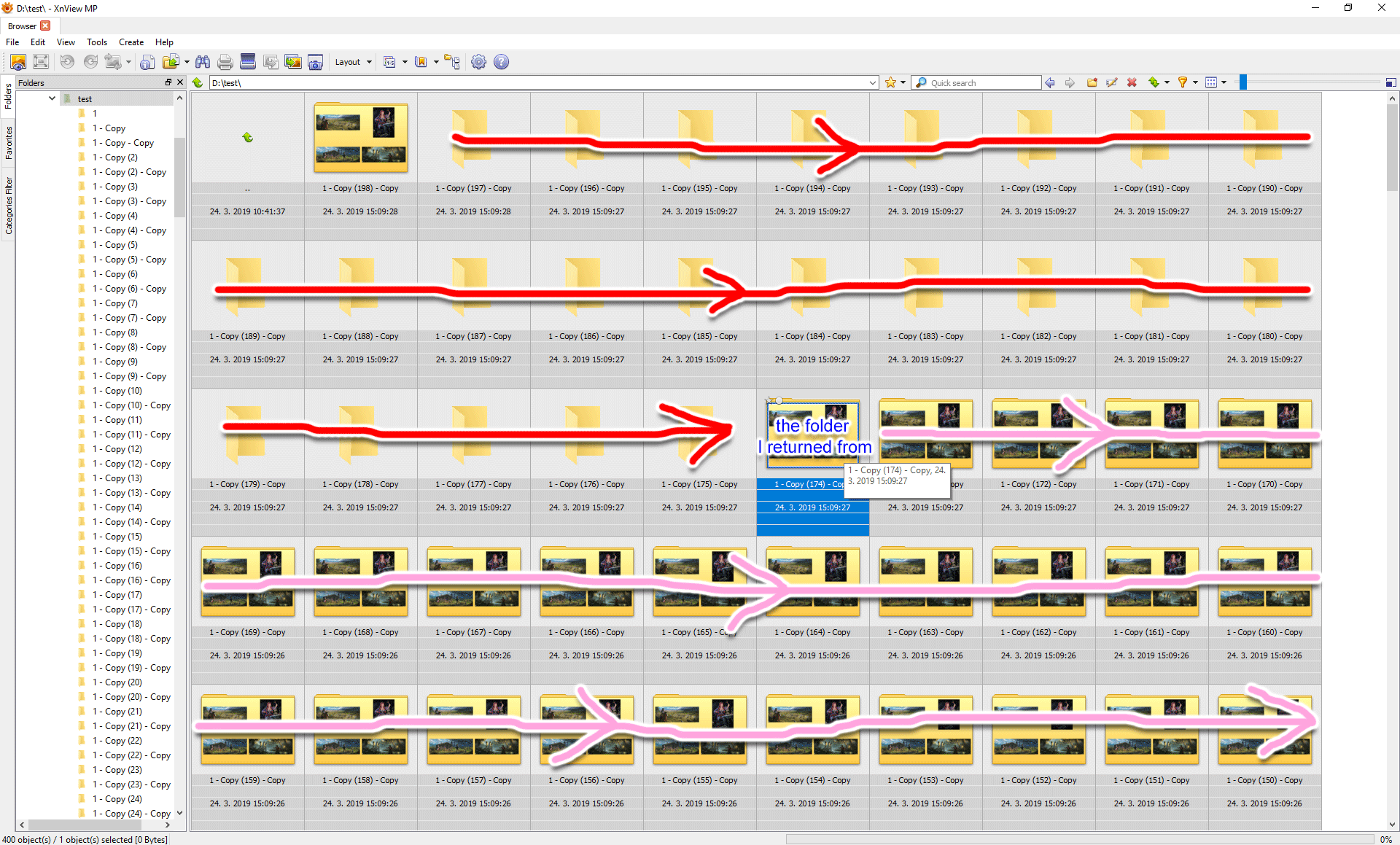

I just want to add that the situation is a bit different when catalog (cache) is enabled (see screenshot below). In such case, the thumbnail folders marked with pink arrow will appear on the screen immediately (with no visible delay). Thumbnails of other folders marked with red arrow will appear on the screen with a delay (and perceived as blinking). The same behavior as described in my 1st (uppermost) post.
Thumbnail loading sequence when catalog is enabled

I’ve got an idea how to reduce the blinking even more. See the screenshots above. Until thumbnails are prepared, the directories have an open folder icon. Later, when thumbnails are ready, the icon changes to another (which is the main cause of blinking, because the icon shape changes). I suggest using the same icon for both directory-loading stages and just gradually add thumbnails to them as they load.
