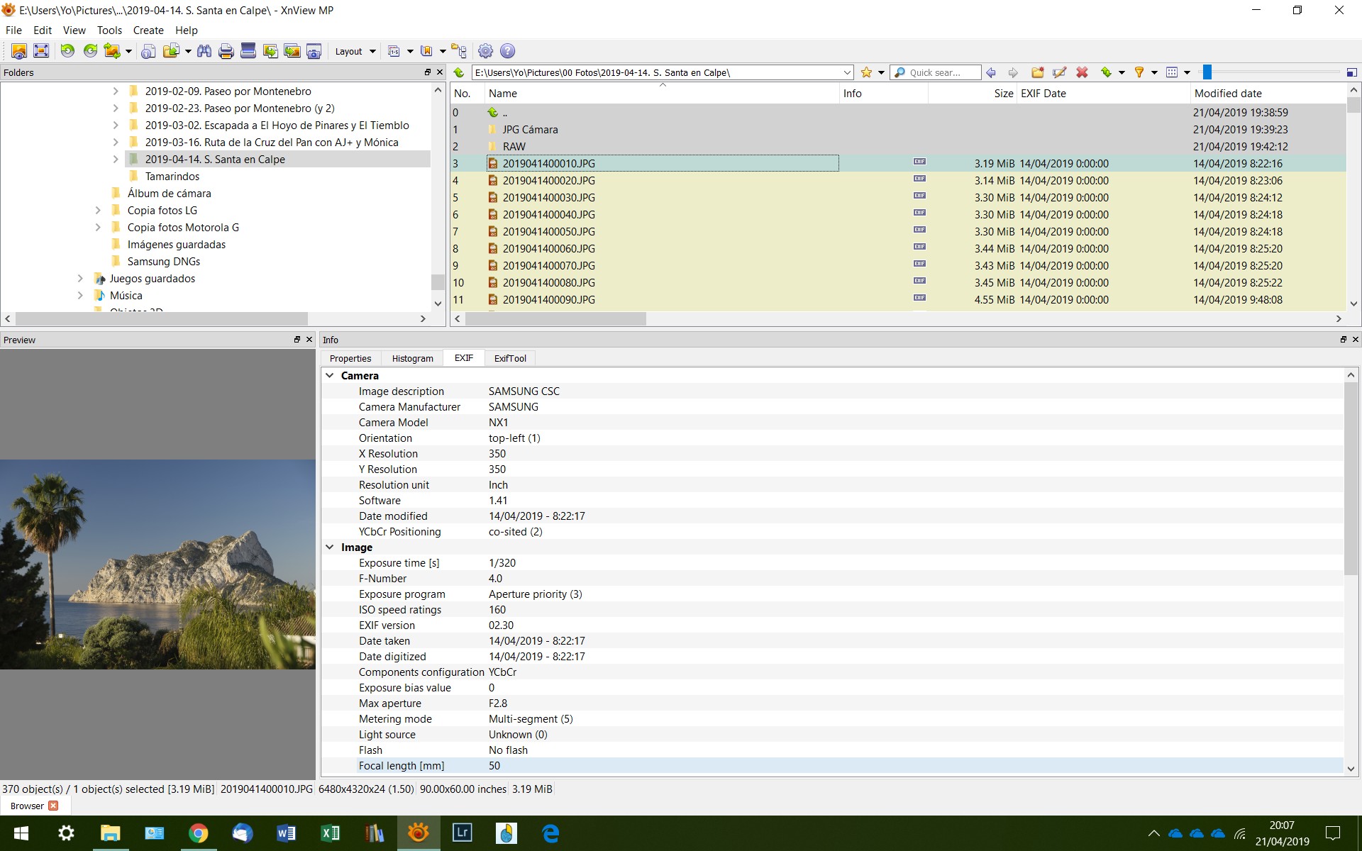

After the use of Attribute Changer the EXIF Date is not correctly shown in Detail View but it seems fully correct in EXIF Tab. Weird.
Just look at the screenshot I upload. All the EXIF Date times are shown as 0:00:00.

there is a problem in the date written "2019:04:21 21:13:442019:04:21 21:13:44", as you an see the field contains 2 dates...

the EXIF date taken has this value

Problem fixed AC. It was a bug in its used FPExif library.
Nevertheless, while fixing it, the guys behind the scenes also say that XnView has some trouble as it's not strictly following the EXIF specification (at least in that Detail view).
I copy the comment Romain Petges (AC coder) has emailed me:
[...]However, the EXIF specification clearly states a fixed length for this type of data. This means that XnView does not fully follow the specifications and ignores the length parameter. The developer of XnView should also modify the code to prevent such issues with maybe other EXIF libraries.[...]
