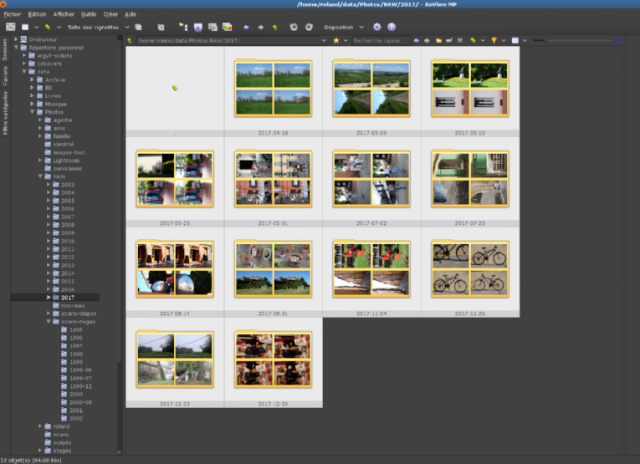

Re: 0.88 Linux. system theme not adhered
That's bad luck for you! On my Ubuntu boxes, these new libs fix the folder icons (see attached screenshot).sissou wrote:No change in icon theme with these new files !
Here's how XNView interface does look on my session :

More information about my system:
Ubuntu 16.04
XFCE 4
When I launch XnView 0.89 without the -platformtheme gtk2 option, the correct desktop icon theme (blue folder icon in my case) is selected.
I can change the desktop icon theme using 'xfce4-appearance-settings' and then XnView (without the platformtheme option) reflects the selected icon theme.
So you could first try to launch XnView without parameter and try to get the correct desktop icon.
