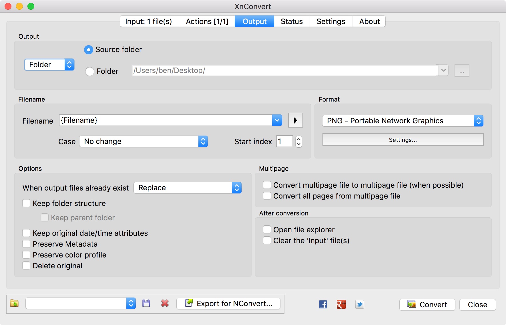

As requested, the output capture is attached
<?xml version="1.0" encoding="UTF-8"?><XnView_script version="1.0" name="ConvertParam">
<Change_color_depth method="1" dither="5" ncompo="256" alpha="255"/>
<Output folder="" filename="{Filename}.png" case="0" startIndex="1" format="PNG">
<Options overwrite="0" orgDate="false" keepMeta="false" keepICC="false" keepFolder="false" keepParentFolder="false" delOrg="false" multipage="false" allPages="false" openExplorer="false" openBrowser="false" clearItems="false"/>
<PNG level="9" interlaced="false" filter="0"/>
</Output>
</XnView_script>

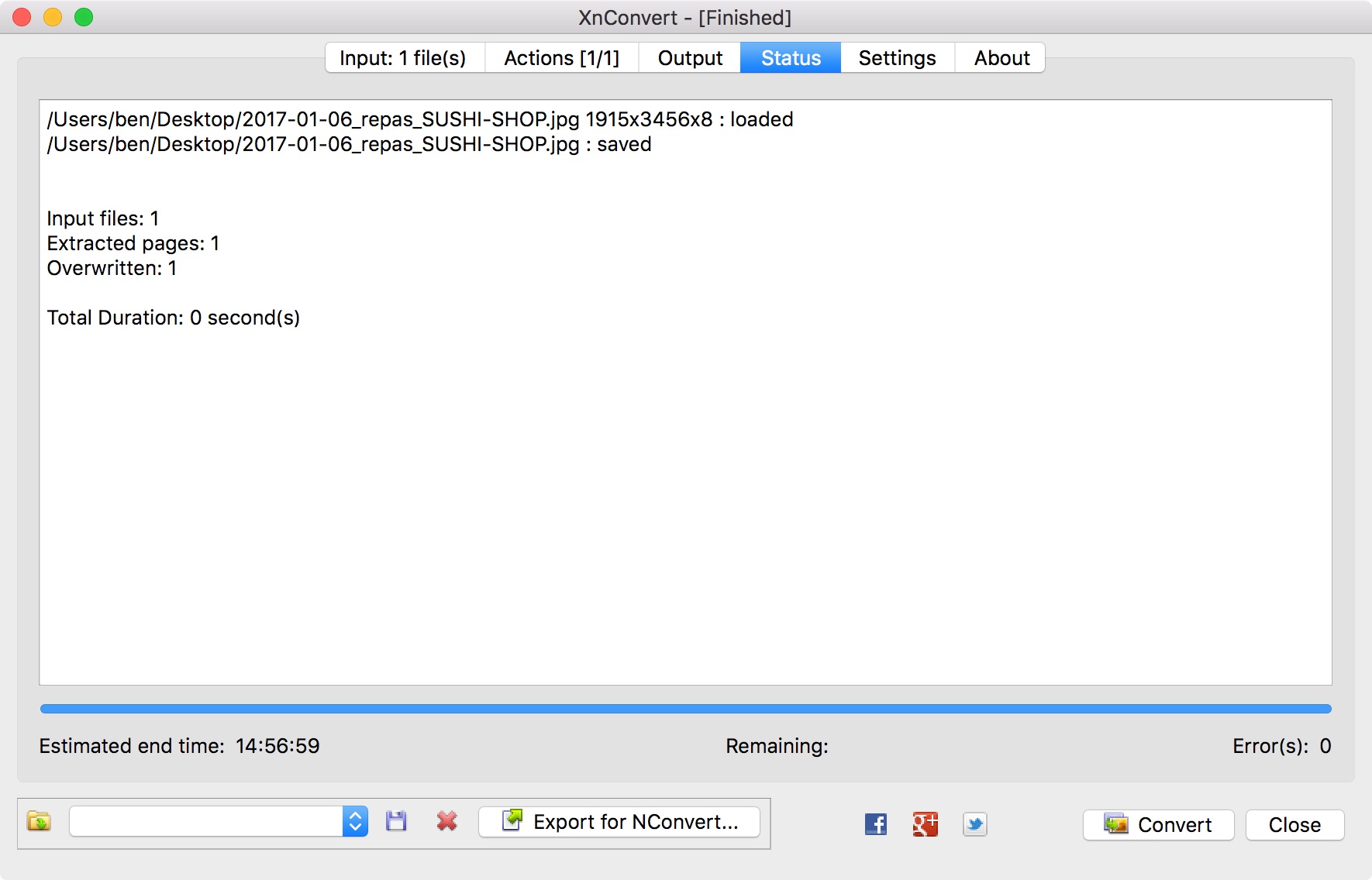

i can't reproduce, could you post the screen 'Status'? And if you use '{Filename}'?

Here are the output and status screenshot. If you want you can access my computer. I'll send you the details in PM

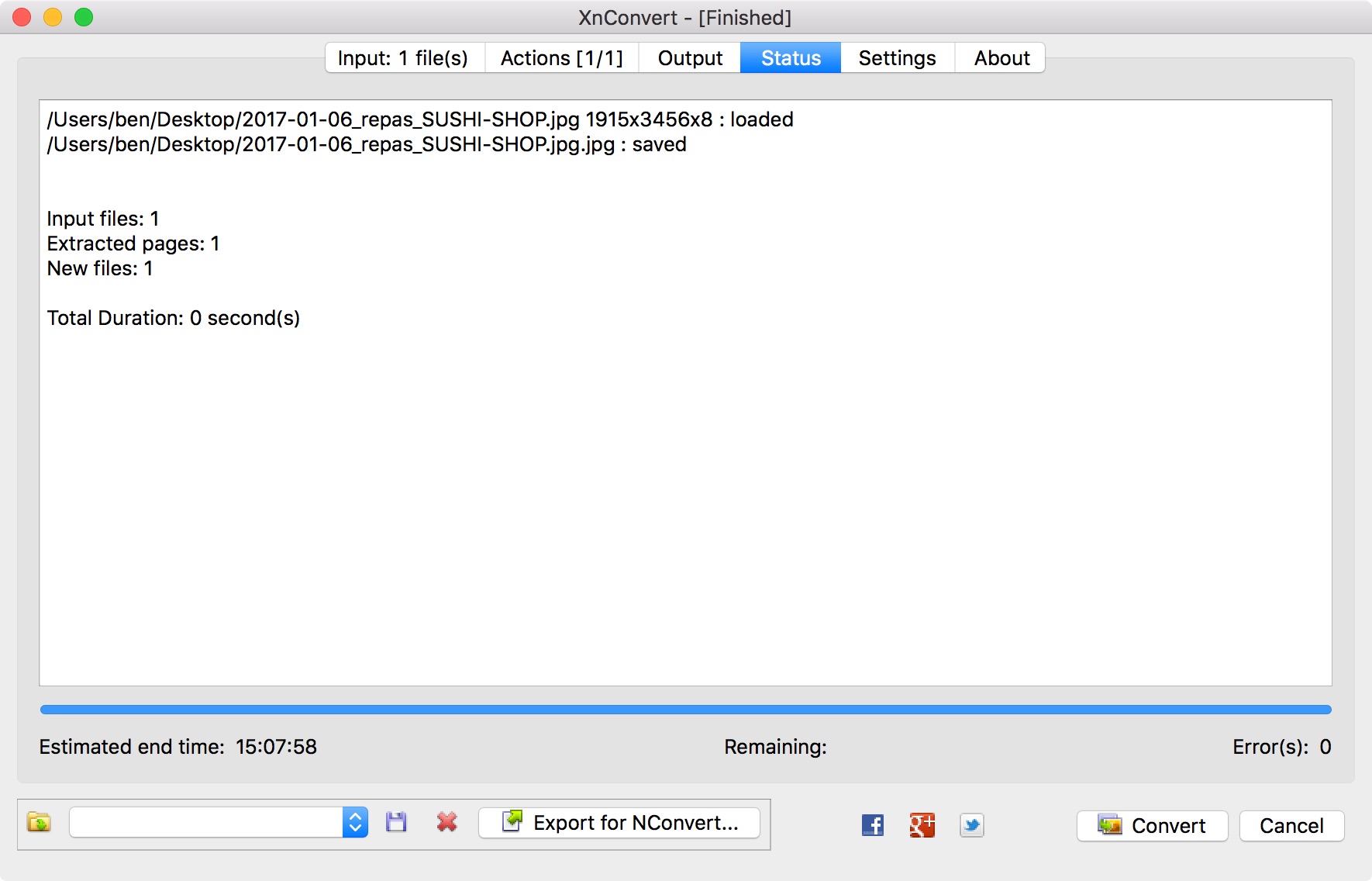

I just tried with 1.70 version, and this is the same.
I used {Filename With Ext}
Here is the status screenshot
