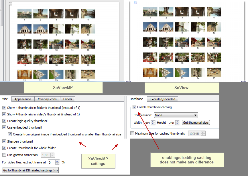

Is this blurry preview in the right hand topcorner how it should be then?
You have the same?
Posts: 46255
Re: XnView Database- and blurred thumbnails questions
So if you have not thumbnail size greater than thumbnail size in database, you must not have blurred thumbnail...
One thing, XnViewMP doesn't invalidate thumbnail in the database, so if you change thumbnail size, you must rebuild them...

Rebuilding thumbnails: I don't know - there is no improvement.Sorry.
Apart from Rebuilding Thumbnails hangs here and there and nothing seems to happen.
=Rebuilding=
SnagIt-27082013 165058.png (43.44 KiB) Viewed 4064 times
XnViewMP-Rebuilding Thumbnails-Nothing is happening-29082013 075722.png (38.88 KiB) Viewed 4064 times
XnViewMP vs XnView (right window panel) Thumbnail 384x288
SnagIt-29082013 081255.png (228.57 KiB) Viewed 4064 times

From your screenshot posted here, I see that you have checked the "Use embedded thumbnail" while the "Create from original image if embedded thumbnail is smaller" is unchecked. Also I see in your latest post that you have JPGs.
IMHO it is an usability mistake since today the embedded thumbnails for the most common file type (JPG) are much smaller than the actual size of the thumbnail in the category of the programs in which XnViewMP competes. For a new installation IMHO the default values would be 'checked' for both checkboxes.
Try to check the "Create from original image if embedded thumbnail is smaller" and invalidate/delete the actual thumbs (go to Optimize | Clean Thumbnails or do a Thumbs Rebuild - it is up to you to choose the method).
Does it make any difference?

The quality of the thumbnails of XnViewMP did improve, but I am afraid they still are a bit below below the XnView(std)
Maybe you can see this on the attached preview.
SnagIt-05092013 131705.png (248.64 KiB) Viewed 4032 times
SnagIt-05092013 134446.png (99.33 KiB) Viewed 4032 times
