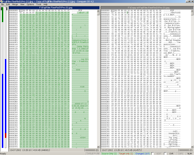

Re: Cleaning Metadata Without Altering Image
Bug confirmed :-|
I used FujiFilm FinePixS1Pro (1).jpg and CompareIt! (Find moved sections & Align mode activated) for my tests.

Moderator & Librarian
Posts: 6512
xnview wrote:when you use 'Clean metadata' in browser mode?
Yes, in the browser. (cmd_CleanMetadata isn't available in view mode, I believe.)
