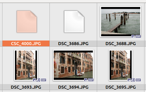

Re: Delete action doesn't delete file?
Follow up:-
I've done some more investigating, and found the following:-
The effect also extends to whole folders. Delete a folder, and it's back when you revisit the parent folder.
I can confirm user iiigoiii's behaviour with image rotation. Rotate the image (lossless), crop the image or apply Map /Negative and the changes are persisted. Still can't delete the file though.
If you delete images some other way ie. terminal window they get deleted as expected under linux. What then happens in XnViewMP is shown in the attached screen grab. Files CSC_4000.JPG and DSC_3686.JPG have been manually deleted via terminal commands, but still appear as files albeit without proper thumbnail piccies.
There is also some strange behaviour with the database maintenance section of the application. The file count listed in the Files column does not seem to change no matter what. Even (as in the case above) externally deleting files from the folder is not reflected in the file count. Clearing out the database and then rebuilding the thumbnails does not alter the file count. So in my example case, the dialogue was showing 311 files, when I'd deleted some and a general desktop file browser was indicating 308.
Turning off the thumbnail caching seems to make no difference to the file count /deletion problem.
But, cutting and pasting into another folder works!
I had the same problem using xnview on Manjaro linux with XFCE. Delete file, it disappears from view but when going back to that folder the file is back. This was when trying to delete photos on an ntfs partition.
I noticed that there is not a choice of 'send to trash' or 'delete' in xnview. I had also recently found that I couldn't send a file to trash on the ntfs drive using Thunar. I tried deleting a file with xnview from my Home folder and it worked fine ie sent the file to trash.
I fixed the problem of no trash on the ntfs drive and now I can 'delete' files from xnview.
This probably isn't the same problem that others are having but it may be worth checking.

'Delete' doesn't delete file: XnViewMP 0.72, Xubuntu, NTFS.
i have the same problem:freebooter wrote:I had the same problem using xnview on Manjaro linux with XFCE. Delete file, it disappears from view but when going back to that folder the file is back. This was when trying to delete photos on an ntfs partition.
XnViewMP; Version 0.72 x64 (Dec 19 2014); Libformat version 6.64
Ubuntu 15.04; XFCE (Xubuntu).
FS = NTFS.
When i try to delete file/files, XnViewMP says that "deleted", and even it/they disappear from the file-list (the thumbnails), but it remains on the the file-system (disk).
If i do "refresh" (F5), then "deleted" file/files return inti the file-list (the thumbnails).
This error persists in both cases: "Use recycle bin" = 'ON' or 'OFF'
("delete to recycle bin" or "delete without recycle bin").
Kindly help.
