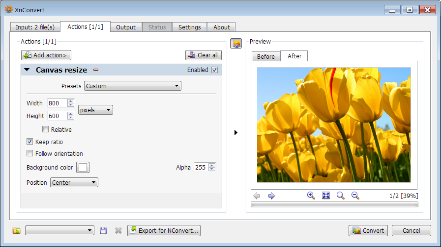

Can anybody guide me on how to crop a bunch of images from the centre and then resize to a specific size? Also is it possible to resize an image to 5 different sizes and rename each output image differently in a single action?

You should be able to do that using the 'Image > Canvas resize' action: you may need to experiment to find the most suitable 'Keep ratio' and 'Follow orientation' settings.

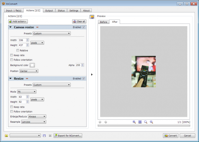

I've tried the resize method and it works fine for photos with same orientation as the target size, which helps a lot. But there are some with different orientation like shown in the attachments here. Is there a way to do that? My goal is to resize/crop some photos to the target size (specifically 63x82 pixels) regardless of the orientation of the original. It's okay to lose details so long as the object in the centre is kept.

I'm slightly confused but could you try the following settings and let me know if they produce the result you want for landscape images like the one you posted:
The first action crops the input image about the center to the pixel height of the 'Before' image and a width calculated from the pixel width of the 'Before' image and the 63/82 width/height ratio of the thumbnail you want.
The second action rescales the cropped image to the thumbnail dimensions you want -- you might try different resampling methods to see if there is any difference in quality.
My output JPG file has a noticably smaller file size than yours but I don't see any very obvious difference in quality -- you can experiment with the JPG save settings on the Output tab. My output image is also very slightly displaced from yours, probably because it is cropped from the exact input image center, whereas you probably cropped by eye.
Note that I haven't considered whether it is possible to use the same settings for both landscape and portrait images, but if the above settings are useful you could try experimenting a bit with the 'Follow orientation' setting and see if you can solve that one. If not, and I don't have experience of that myself, could you post portrait and landscape Before and desired thumnail test images.
