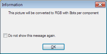

The input TIFF is CMYK and XnView can only open it as an RGB image:
Could someone advise on the optimum settings to use in the XnConvert 'Actions' tab to maintain the original colours?

Re: problem with conversion from TIFF to JPEG
ok, right, the icc profile is not converted here...
Posts: 46236
See Issue 372 for current status and details.

Posts: 46236
dudijr wrote:Cause I still have this problem :(
yes it's a bug
