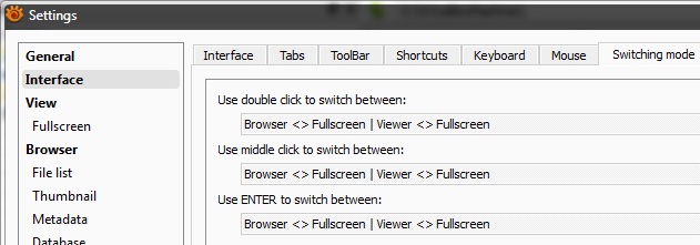

Re: Switching from viewer to browser un-maximize the window
I want to confirm the existence of this problem.
Using the latest version of the program.
1. If I use the Enter key or the middle click, the correct switch mode: Browser> Full Screen | Full Screen> Browser
When using a double-click, the image opens in a new tab.
2. Changing the double-click action is not saved,action always remains as in the screenshot.
