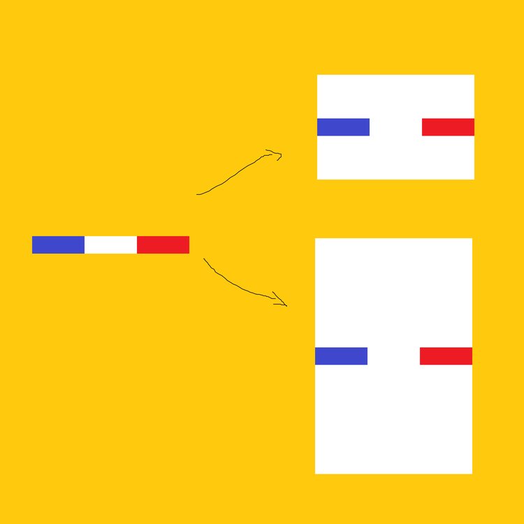

I was pondering over that smart orientation feature.
(see illustration)
say you have the 900x100 pic and you want a 4x6 print (aspect ratio 1.5)
I was thinking you could do
900/1.5 = 600
so 900x600 (aspect ratio 1.5)
or you could go
900 x 1.5 = 1350
and 900 x 1350 (still aspect ratio 1.5!)
however you always divide, right? (or do you?) haven't thought this out completely.
or do you determine the "short side" first?
(see illustration)
900/1.5 = 600
or you could go
900 x 1.5 = 1350
- Attachments
- incorrect resizing
- example.jpg (22.14 KiB) Viewed 1969 times
Re: aspect-ratio-based canvas resize
like I said, I think the hics will be with square or near-square pictures.
how do you decide which way to resize? (assuming print size is non-square)
say a bunch of scans come out
500x500
498x503
504x499
etc...
you could have a setting force add border left+right or top+bottom if 1 < aspect ratio of pic < aspect ratio of print ? (we presume aspect ratio is larger number divided by smaller number)
in which case you pretty much assume the user has all their scans correctly oriented.
500x500
498x503
504x499
etc...
If you think about it, wouldn't it always be preferable to oversample?
For instance:
For instance:
If I understand you, the 2nd option would better preserve the image quality.I was thinking you could do
900/1.5 = 600
or you could go
900 x 1.5 = 1350
John
no, because you're just adding borders. look at the pic. the borders are just longer. the pic would turn out tiny while the borders would be huge.JohnFredC wrote:If you think about it, wouldn't it always be preferable to oversample?
For instance:
900/1.5 = 600
or you could go
900 x 1.5 = 1350
