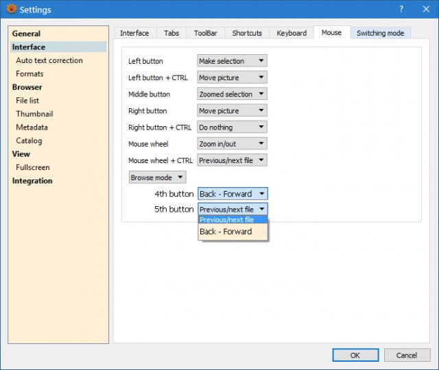

What I am saying is that in Browser mode, the previous/next file don't have sense. Then I propose that in Browser mode the button 4 &5 of the mouse get the same function that they have in the most cases in other software: Back - Forward in the navigation.
And the best solution could be the possibility to select the function (here a simulation):
Thanks whismerhill for the X-Mouse Button Control, I will try it.
